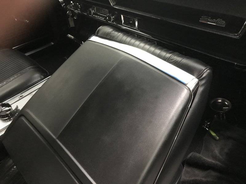

SEM makes a texture spray that you can cover with the paint color of your choice.
:thumbsup: I’ve used this on consoles, seat backs, etc. It works very well. You can control the texture size by distance between the can and object. I usually lightly sand it before painting to flatten the peaks and make it look like molded texturing but it depends on what you are matching.
