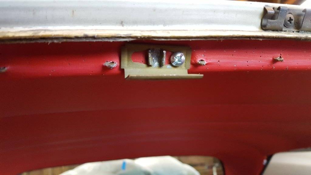

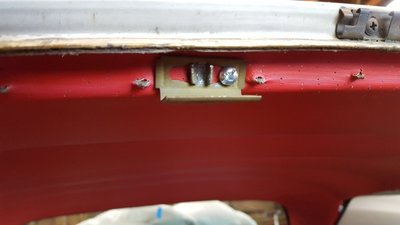

The rear tab on the bracket fits in the hole then you squeeze the front tab holding the bracket in place. After market ones are available but mine didn't fit. They were too long preventing the trim piece from fitting tight against the headliner. The old ones don't like to be bent over and over. I ended up modifying mine. The last pic is a modified version of what you ar looking for.

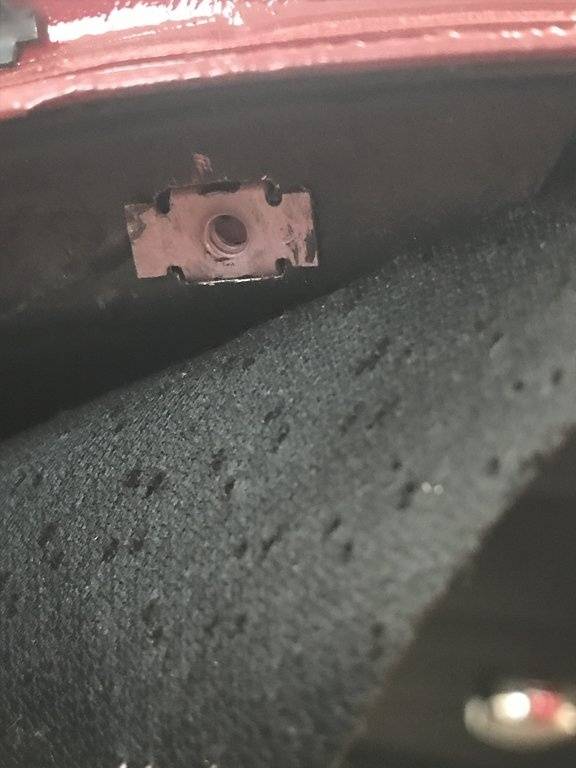

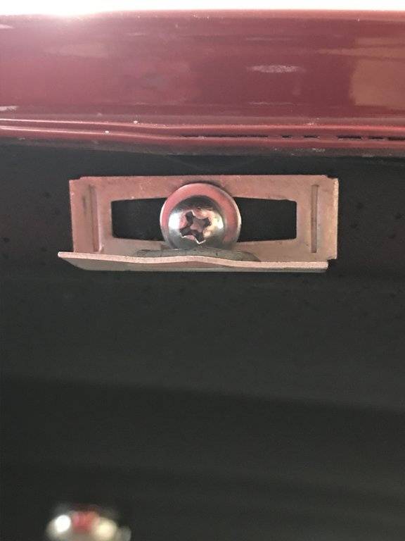

The clip snaps in to a 1/4 inch hole. (4) Then you need to squeeze the tabs together , that usually tightens them up in the hole. I did not trust the clip on its own , so I added a #8 sheet metal screw in the corner. See picture FYI this was done before the windshield was installed. I don't know how you would get those clips in securely any other way. If you don't get a decent picture, I can take one tomorrow.

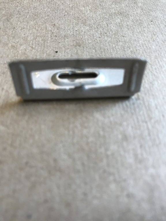

Thanks for taking the time to help. I don't think mine look like that. Mine have a slotted hole for the screw. They look like they clip in near the glass then 90' bend .
Look at my last pic and you can see the slotted hole. That's where your trim screw will go.

Thunderlugs yes you are correct they do look like mine. When I posted my last reply I started before you posted and I was looking at the pic's Texas69bee had posted.
