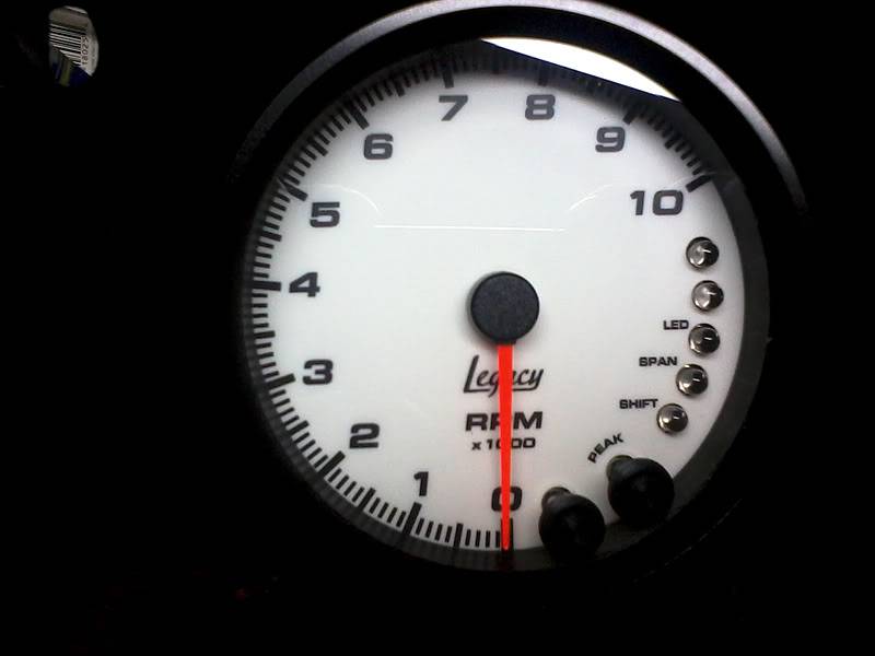

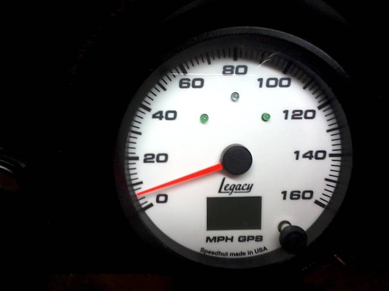

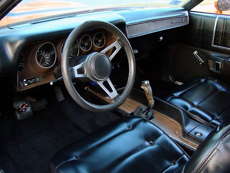

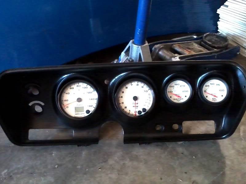

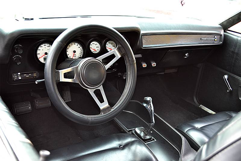

I decided to give the interior a little different feel, so I decided to go black instead of woodgrain. I picked up a spare bezel and stuff off Ebay so that I could keep my originals.. I got a carbon fiber pistol grip, replaced the woodgrain decal on the console with black decal, and picked up some white faced gauges..
I was limited on gauges because I needed 4" the standard Autometers were too small, or too big for my openings, I found these from Speedhut (they also make the standard sizes) but all built to spec per your order, you can get a ton of different looks including your own text and graphics if you would like.. Made in the USA, only 1" deep..
Anyway, some cool features
GPS Speedometer (with turn signals and high beam indicators) does not require a transmission sensor or cable.. Shows 0-60 Time.. 1/4 mile time and speed.. elevation.. Peak Recall max speed.. Compass.. GPS Clock.. etc..
Tach of course has Peak max recall.. 5 LED shift lights which are programmable.. can also hook up external shift light.. shift lights can be set with day/night brightness settings

Interesting. I like it. Cluster looks cool. To bad it can't hold more gauges but whats a guy to do? Are you going to do something with the dash insert? Maybe the same covering that you used on the console lid?
Do you have any pics of the backside of your cluster setup?

The dash insert is black, painted the same as the gauge bezel. It's got a glare on it in the photo, but it matches.
I will have to look at home to see if I have any photos of the backside of cluster.. I think I might, but not sure.

Did you pain the bezels black, or did your order them like that?
