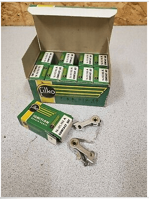

I kept my dual point in my 273. I have a stockpile of NOS Filko points and a few condensers. A rotor or two and a brass contact cap or two. I have enough parts for many years of cruising. Keep it simple!
