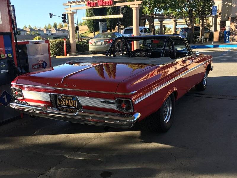

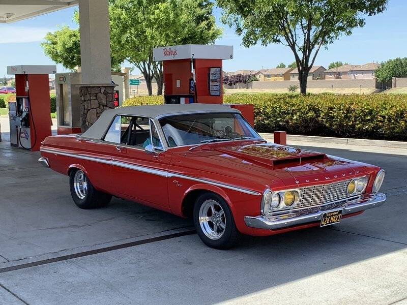

Sure it is Don, but how many dead cars owners have been looking for help about why their car is dead in just the last few weeks, while us Dinosaur points guys are out there cruising day after day. I carry a pocket knife, just in case...

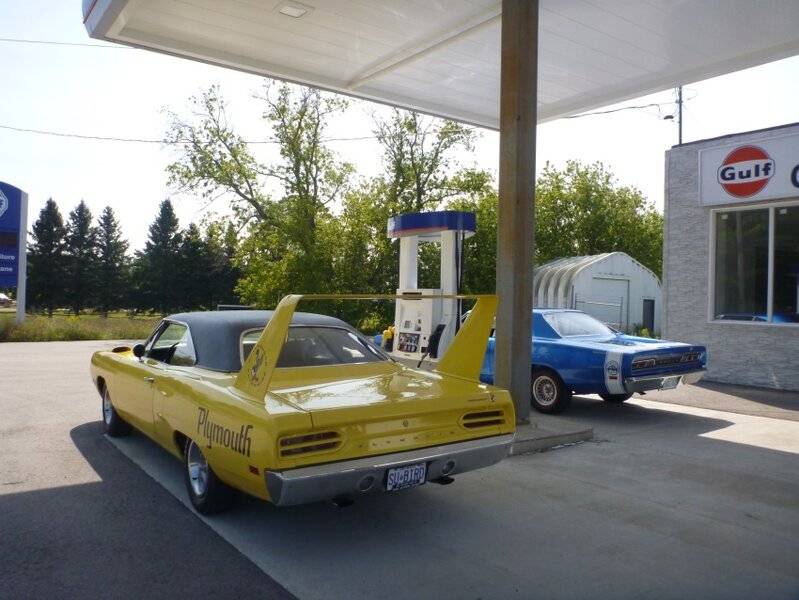

Hey, Dad... I can do that too! MSD Pro-Billet electronic distributor, FiTech dual EFI throttle bodies and; best of all, top UP or top DOWN...lol.
