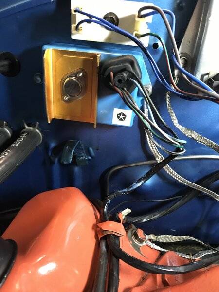

View attachment 1129763 Was chasing this EXACT gremlin this month, I would get 5-7 miles and then just shut off, then crank rapidly (indicating no spark)
Cool down completely and fire right up.
After searching some old threads on this site (you can sure learn a lot from them) I figured after a new coil, it had to be the old orange box.
I contacted a great supplier on this site, HALIFAX, I he had NORS blue boxes, I bought 2 (need a spare) got them in 3 days.
Gave the car a long hot run and so far she’s good
Ps, never hurts to also have a ground strap to the block

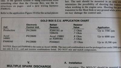

I know the "kits" out there come with a 1.25 ohm ballast and some of the MSD Blaster coils say to use a 0.8 ohm
when using the factory ignition, so I get confused on which is more important not to potentially damage with
the "wrong" ballast - the control unit or the coil?
Contro unit really needs it matched.
FYI
Thanks as always Double H - I have the 0.8ohm one on Fred right now but looking at that chart
(as I have the other times you've posted it), I still can't come to a conclusion really.
I mean, it's all over the place according to what ECU is on the car (and I don't see a listing for
"old orange box from the 80's" categorized on it :-) ).
I have made it a point to feel the MSD Blaster 2 after a couple local trips and the rascal has been
pretty darn warm, almost to the point of being too hot to touch. I don't know if that's normal or
if it means it wants a different ballast (higher or lower rating even?).
