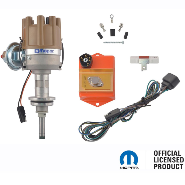

Daytona clone, basically stock 440 with Mopar electronic ignition. Started and ran fine 3 weeks ago, tried to start ran about 10 seconds and quit. A couple of times it ran 4 - 5 seconds, but now nothing. Fusable link checks OK with test light, power to coil (11.3V) and 11.3 volts on neg coil post also (this right? neg post "hot" also)? Gap on distributor inductor coil checks ok at .008" per recommended (brass strip of course). No spark with plug connected and held to ground. Ground checks ok on motor, firewall, and radiator support. Power to electronic control module checks at 11.3V. What volts should I be looking for in and out of resistor on firewall? Any other ideas/suggestions?

Ballast resistor 12v in & 5V out (???). Unplug center distributor wire & place it near ground (still connected to coil). Disconnect “double bullet” plug at distributor. Turn ignition to run. Ground exposed bullet connector on wiring harness side momentarily. Every time you ground it, the distributor wire should jump a spark to ground. If spark jump - problem is distributor (cap, rotor, reluctor). If no spark - problem is coil, ignition box or ballast resistor. Check ballast resistor continuity with nothing plugged into it. That’s the most common problem

The control module creates the coils path to ground THRU the control module's large silver transistor on the front of the control module. The reluctor in the distributor goes into the control module and creates electrical pulses that switch that large transistor on & off mimicking the opening and closing like points would have done to switch the - side of the coil to ground.
With ignition switch in "crank position", you should see full battery voltage on both sides of the ballast resistor as the ignition switch electrically bypasses the resistor. When ignition switch is in "run position", the resistor is electrically in the circuit path, and you should see full battery volts on the one side of the resistor and a REDUCED voltage, (about 2-3 volts lower) on the other side of the resistor.
