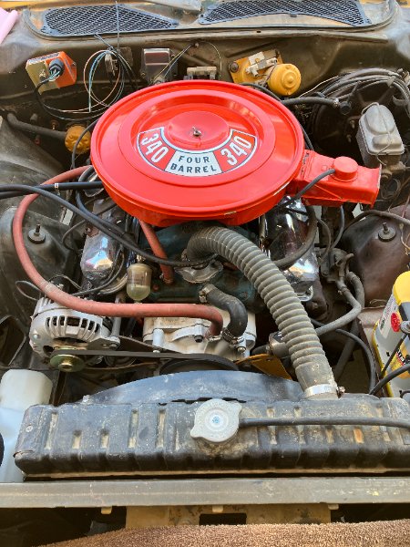

Update: Finally installed the correct 1972 "trap door" air cleaner and hooked up the 1973 NOS EVAP canister.
I used a 5/32" hose from the Thermo-quad rear non-ported manifold vacuum fitting along with a 5/32" tee in order to connect the air cleaner diaphragms as well as the distributor vacuum advance.
I used the ported 5/32" fitting on the front of the Thermo-quad with a 1/4" hose adaptor to the 1/4" purge port on the canister, a 1/4' hose from the fuel tank vent to the 1/4" vapor port of the canister, and a 11/32" hose from Thermo-quad bowl vent to the 11/32" fitting of the canister.
Distributor vacuum advance is using manifold vacuum for now (may change in the future).
