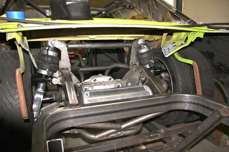

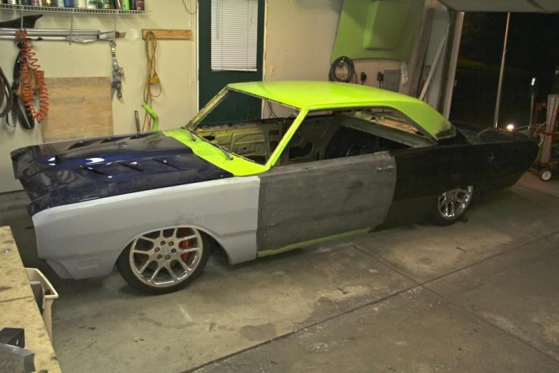

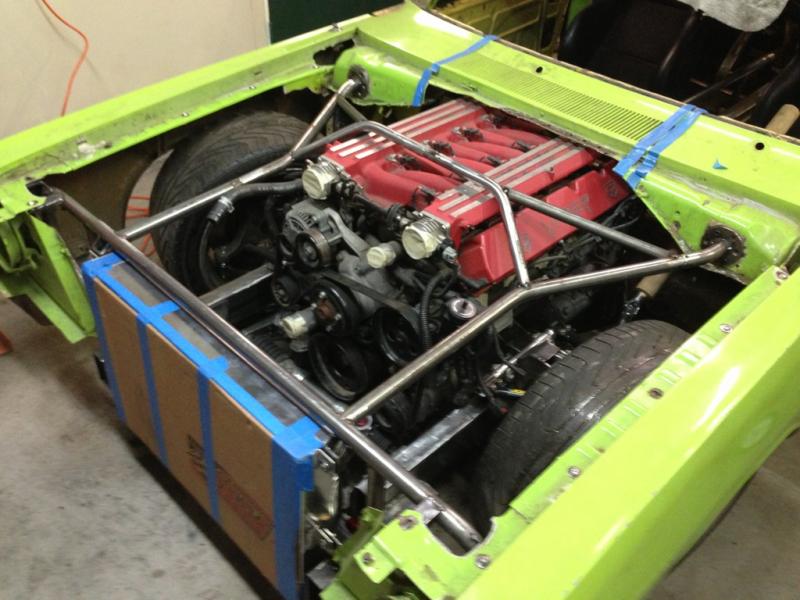

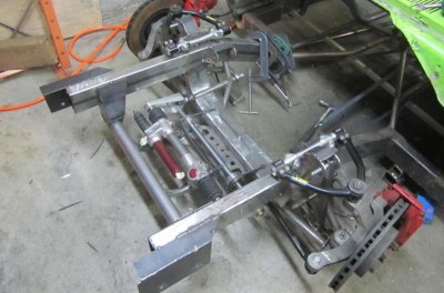

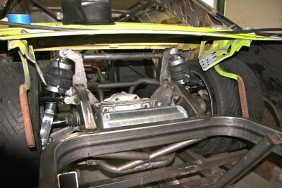

There is a 69 Dart on Pro Touring Mopar that is getting a full Viper setup to include engine and trans. It is a work in progress but is really nice.
http://www.protouringmopar.com/showthread.php?19-Project-SCUD-69-Dart&highlight=viper
P.S. he is building it in his garage on a home made frame jig.
