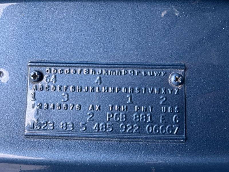

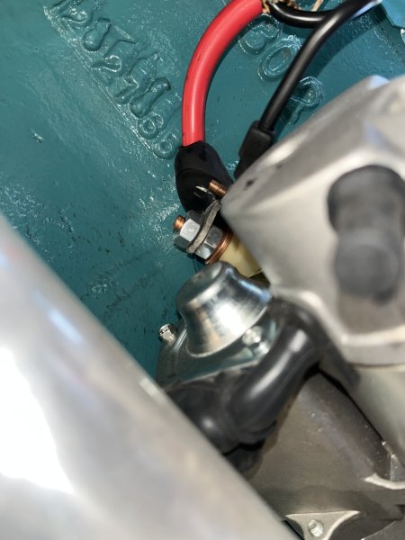

What make a block date code correct? How much before car production would be considered date code correct? 69 B body
