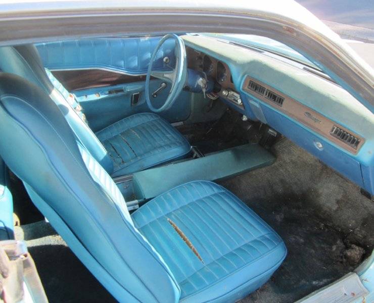

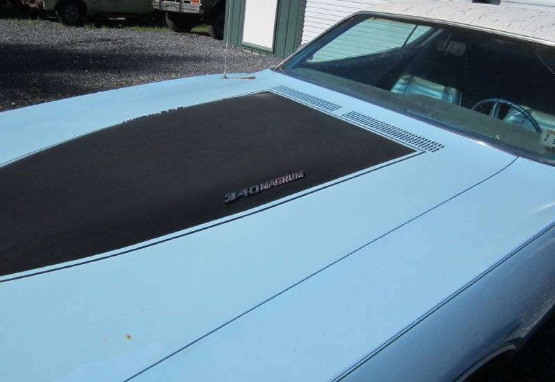

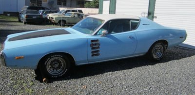

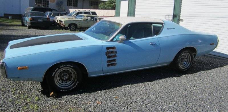

Thanks for the help. I bought the beast yesterday! Now the work begins. Is a little rough but optioned nicely. Has the same interior as my first car I bought 40 years ago when I was 16 - 1971 GTX. Am questioning the pattern on the seats. They are the same as 1971 but most sources say they changed the pattern for 72. Are well aged and appear to be original or redone a very long time ago. Data plate decodes to blue high back buckets. Wonder if anyone else has a 72 that came with this seat pattern?
There b body seats but look like ply to me never had anything like that in any of my chargers

That looks like a very solid car ! I can't believe two 72 rallyes pop up at the same time . Congrats make sure you make a build thread I'll be watching and if you need anything just ask I have one here apart and I've been threw 10-15 of them over the years .
