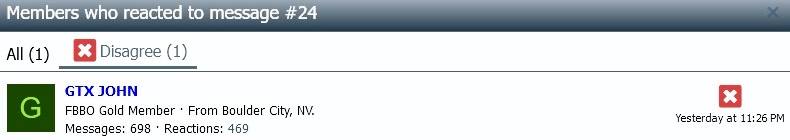

@GTX JOHN : It's fine that you disagree....but with "what"? Did I value it wrong? - if so, is it "scrap rate"? ...nothing?, or $500? ... or more? Is it something else you disagree with? I value other's opinions on things like this - would appreciate more than a "drive by".
Thanks
Mark

I think I hit the wrong post with the Dislike button = Sorry a lot of distractions at
the race track.
If the 318 forged cranks are standard, I have been selling them for $150.00
All good - my "thumbnailed value" may have been optimistic :D I'm still above water if I sell it in the range you do. Who know what I'll actually ever wind up doing with it - not me! LOL. Couldn't pass it up, tho...addict
