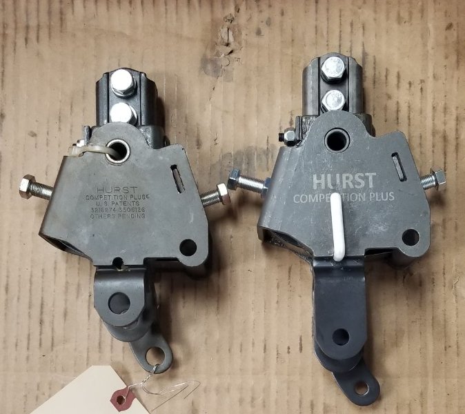

Side by side comparison of the 68/9 lever length on the left vs. 70 B on the right. We have new 70 B body shifters available. 1970 B-BODY COMP PLUS HURST SHIFTER MECHANISM 7174 REVERSE, NEW - Mopar A833 4-Speed Transmission & Component Specialists 70 Shifter requires the 70 shifter rods also. Levers and mounting plate remain the same.

Thanks Dan. So is it all three shift rods that are different then? I thought you could adjust 2 and the reverse rod was totally different. Or are the size of the holes in the mechanism needed the reason. I can’t remember… Thanks again for the info..
The 70 shifter box will shorten the throws, but your handle might not fit. The 70 box from Brewer's takes a bolt on handle. If your handle doesn't fit you might be able to modify it, or you could buy a new handle. Hurst makes an assortment of bolt on handles.

Yes. The 1/2 and 3/4 rods are about 0.75" longer...sometimes you can make the 69 and older rods work...sometimes there aren't enough threads screwed into the adjuster button. In our linkage rod kits we make the 1/2 and 3/4 rods the 70 length and just thread them further so they work for both applications. Stock rods aren't done that way.
