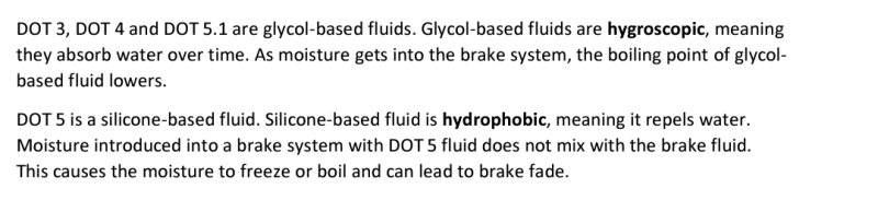

DOT 5 is also good if you want to preserve the paint in your engine compartment and/or paint your master cylinder and have it remain that color rather than rust.

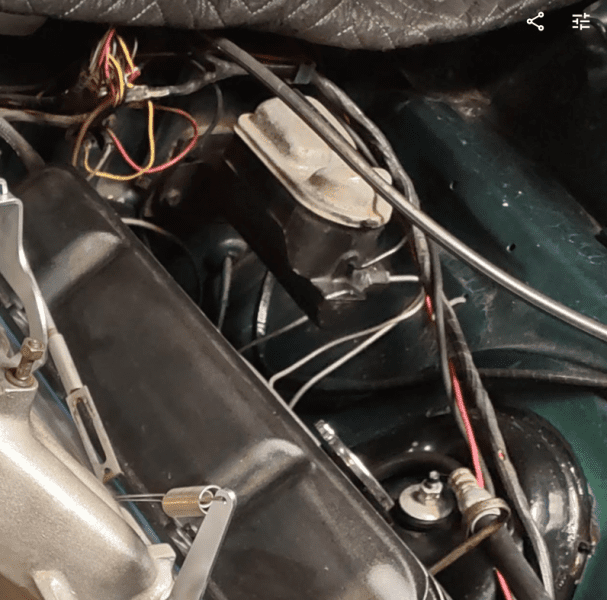

This one has been in there since the 90's.
I painted it just before I installed it:
