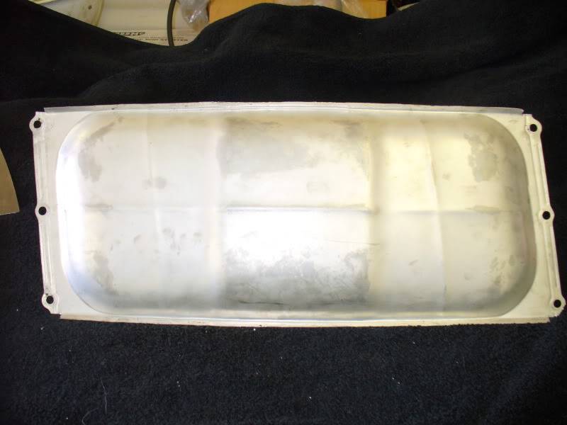

I have some parts off the 440 for refinishing and got to looking at the valley pan and thinking how bad it looks. Can you paint it? Is there any difference in pans? Two at summit, one is $25.75 and the other is $31.99 and I couldn't find any difference. Any help? http://www.summitracing.com/parts/fel-1215/applications/year/1968

They both include gaskets, but what are the 3 round O ring lookingthings in the pic's?

Yes they looked the same to me.

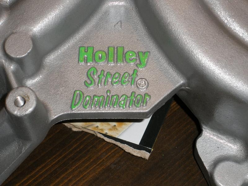

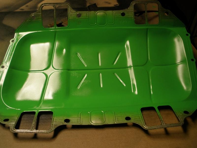

Thanks for the info, still trying to decide if i'll use it or get a new one. I'm playing around with it right now, painted it green to match the green on my valve covers. Thinking about making a mopar M stencil and putting a black M on it. I'll prolly do that then strip it, paint it black with a green M and see how that looks. Painted the writing on my intake green to match also.View attachment 98762P1191653.jpgP1191655.jpg

Like the green paint touch-up. Makes it personal and yours.
