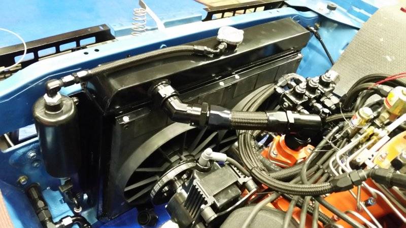

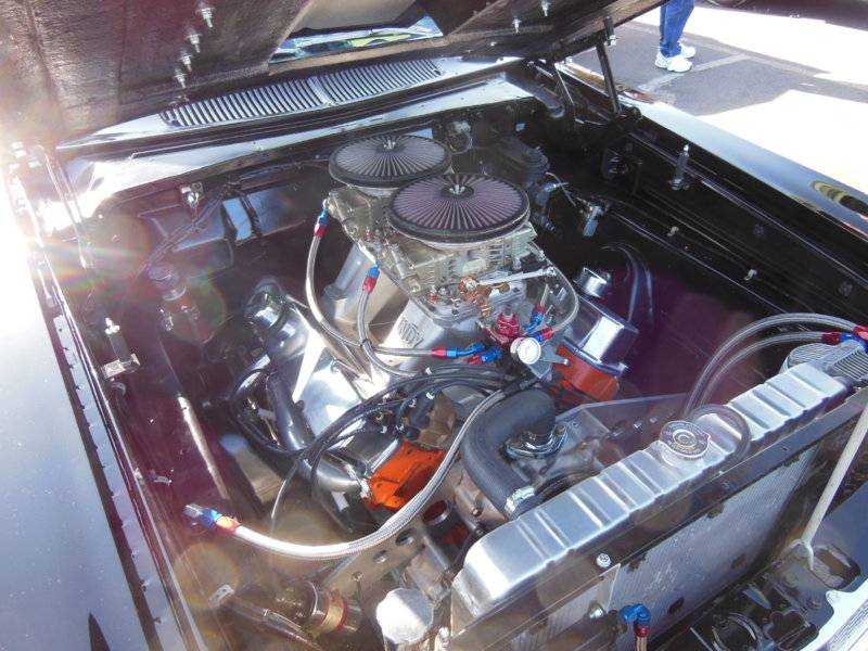

I run a Meziere electric water pump on the street that bolts in style housings and had a custom 26" custom radiator with shroud and dual electronic fans. You will definitely want a 26".

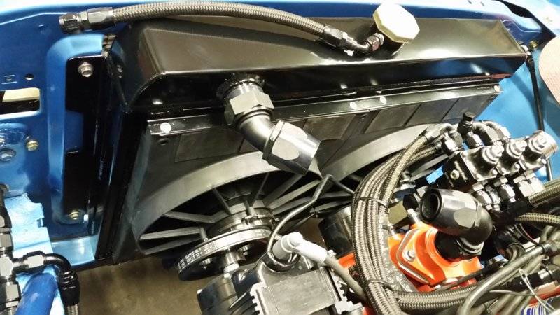

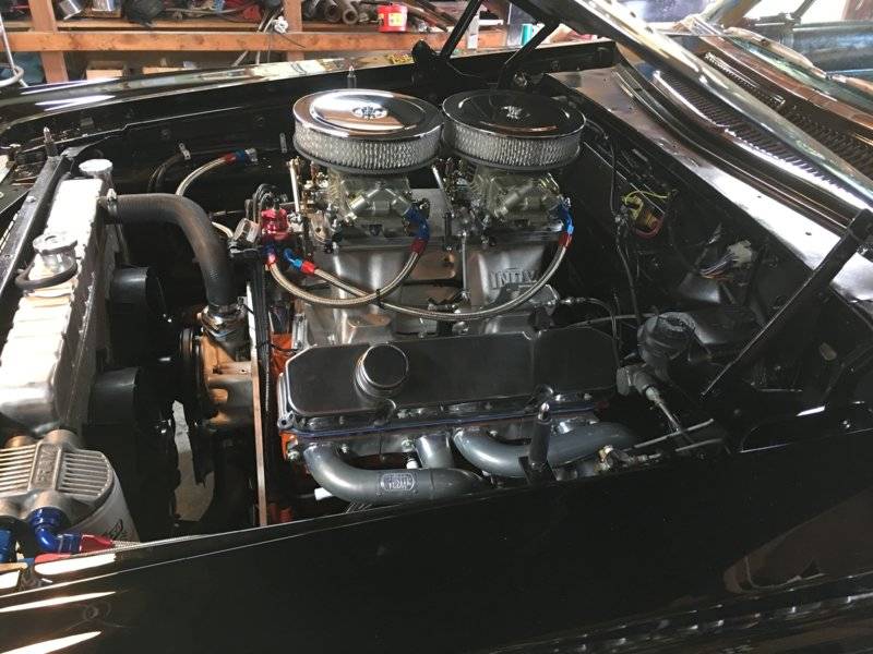

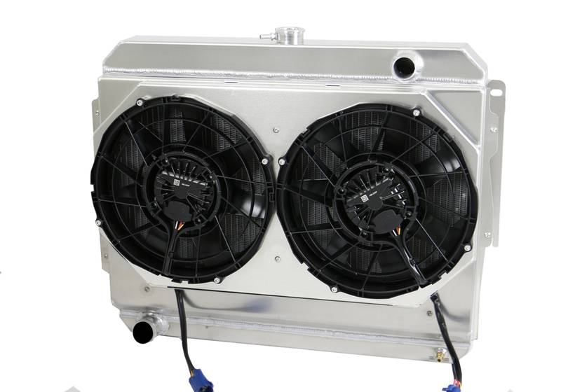

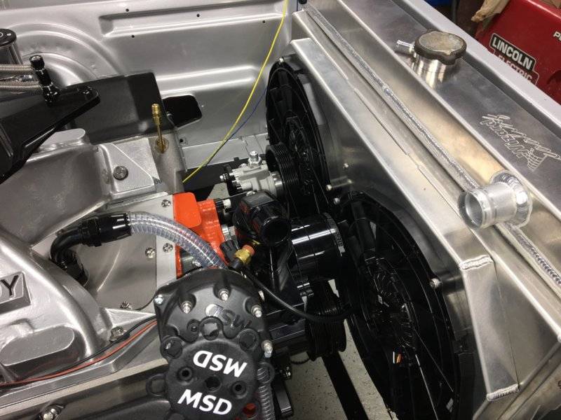

Meziere here also with 1.5" tube Wizard 26" and brush-less spal fans!
This is the thinnest package with electric fans you can get. A bit pricey though at $1600 bucks or so. My car never runs over 167 degrees ever...

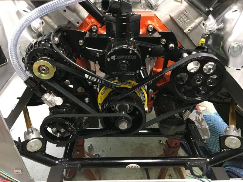

Sorry I meant to ask 6pkrtse. That is badass 2quick!! Where did you get the ribbed belt pulleys for the alternator and crank, and which alternator brackets are you using?!?
when i ran an electric meziere a few years ago, it would not keep it cool. no matter what i did the temp would always creep up. when i took the electric unit out, and put the high flow moroso belt drive unit back in, that stopped the heating problem, all street driven.
Would it creep up while cruising, or stop and go?
The crank pulley cam from March Performance the power steering pump came from KRC it's an aluminum Chevy type II road race pump, and the brackets were a combination of Moroso, KRC, and the water pump brackets were custom made by me that I had anodized black.

160 and I swear It doesn't matter what the temp is outside or if it's idling in traffic the only time it ever gets to 180 is if I'm really hammering on it for awhile, then within 30 secs it's right back to 170.
One thing I will add is the housing is a Meziere 55gpm version, the pump that came with that housing was to long to clear the radiator, so I sent it back to Meziere and they switched it over to a 35gpm pump but still used the 55gpm housing, so it's actually a hybrid that Meziere claims should flow about 45gpm. But seriously, it works and my motor is 11.5:1 so it should run hot. Coolant temp is just something I don't worry about. Those brush-less fan are serious. For the most part they come on and off at a fairly tame speed, but when needed they really start to sing, it'll blow dirt/gravel from under the car.

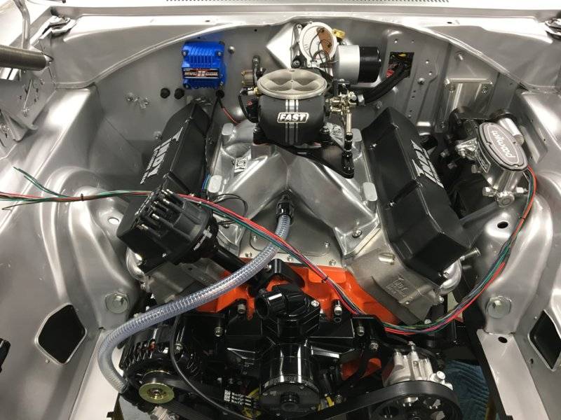

no worrys there, the only accessory bolted to the housing is a brace for the low mount alternator, the question is wheter i can pop the housing off the plate, without disturbing the seal against the block....
I would unbolt the motor plate from the frame and jack up the engine just until you see the plate take some pressure of the frame rails, this way the engine wont want to slide down the plate. hopefully the RTV will hold the plate on the block for a bit with minimum weight on it.
