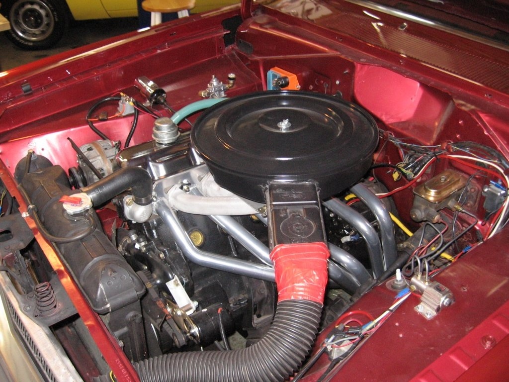

Don't laugh, yes it's a Slant Six,But it did make a difference with the cool air charge from outside the engine compartment.2 10ths of a second.Cost $10 bucks.If it works for you,then you can go to the fancy setup.Just a thought..

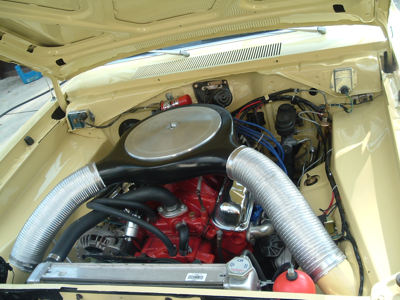

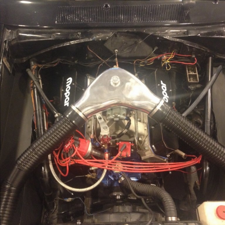

Where did you route the intake pipes that the flex line hooks up to? Where exactly is the intake vent? In the fender well? The photo you put on the post on the bottom right, is the "box" I think I am going to. The other problem I have is negotiating the pipe over and/or around my Pro Billet Distributor located between the altinator and the water inlet on the engine. I sticks up so high that I will not be able to run the piping over it which pretty much eliminates the "box" with the 45s on it. Straight shot would be nice, but it ain't going to happen. I really like your set up. Nice detailed engine and compartment.
Canyon 707, That is how I wanted to run the intakes. I see you went over the Pro Billet dis. How much room from your carb flange to the hood interface do you have? What engine?
non. its tight 440 with M1 manifold and a 1050 holly Spectre is the company that makes that and its also maked it for 4150 each tube goes to where the headlight use to be I actually used a sheetmetal reducer 5" to 4" home depot has them.
