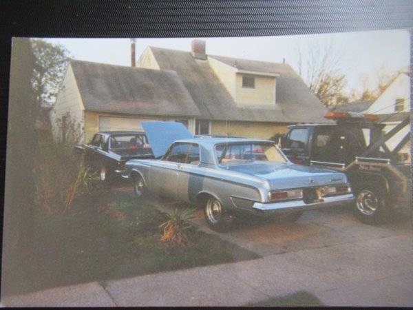

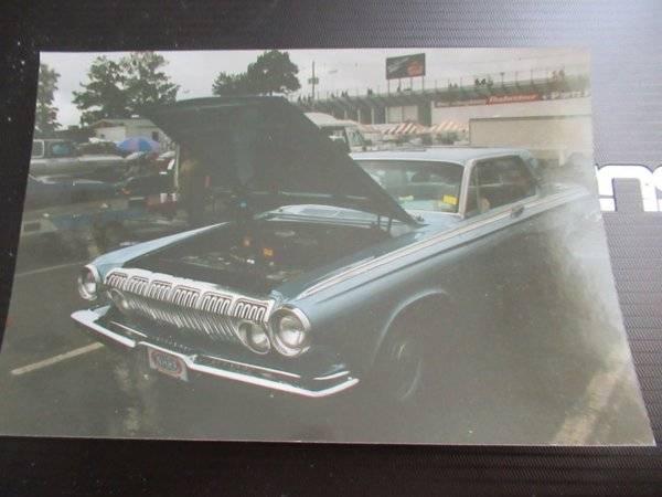

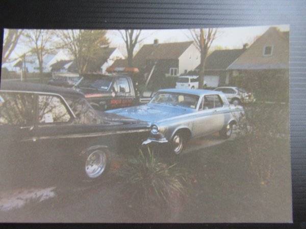

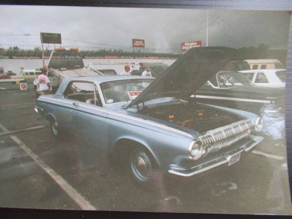

Back in the day I had a max wedge,the piston slap drove me nuts 'till it warmed up and went away!!
