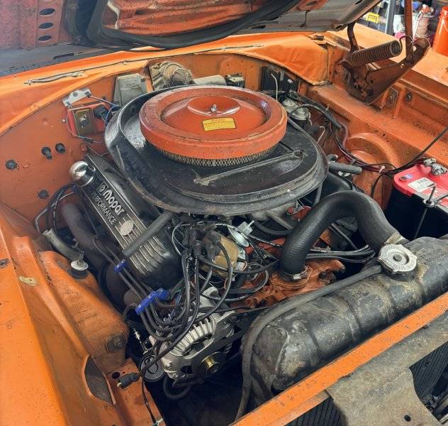

Hello All,
I was driving my 70 Superbee and after stalling at a light I noticed a noise between a click and small knock to the engine not super loud but noticeable like a bad rocker or small knock.
compression Tested all 8 cylinders and all but lovely #6 are performing at minimum 130 psi. #6 is hitting 60 psi at best. #6 spark plug was also wet and oily unlike the rest a bit more dry.
Is this a blown head gasket issue or more? I have only test compression and changed oil. No signs of metal shavings in oil change.

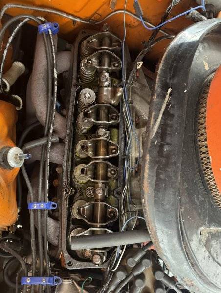

Whelp you were right! Worse than expected I have lost the push rod and have lots of slack in other rockers. Send help sos
Is there a hole in the rocker? Have to look see if the lifter blew out/ apart. New lifter( maybe) pushrod and rocker, probably good to go
Might not be to bad,I have bent 2 pushrods in my 440 and had no damage to the engine. Slapped two in and all was good.
What kind of oil do you use in the engine? Lifters alone might not be the answer. If the lifters are taping id expect a lobe or 2 gone on the cam. Take the intake off and inspect the lifters and pull them. Then check out the lobes on your cam.
Yes will do all of that. Was running 10/40 on an older engine
I'd like to see cam lobes...was this built during the rash of poorly hardened cores? Or mirror flat lifters?
