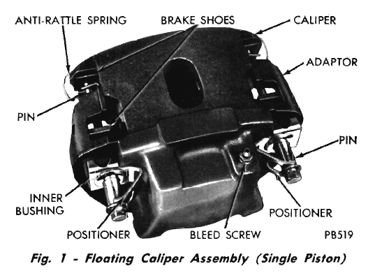

Just found that three of the four "positioners" (that is what the FSM calls them) on my 1972 SSP are rattling around loose on the caliper pins because a piece is broken off of them. What do they do exactly and what happens or (does not happen) if I drive around in this condition. I did find a disc brake hardware kit from Bill Rolik that looks like it contains what I would need. Thank you.

From the diagram I posted above, I am thinking that these "positioners" help to even out the static gap (between the disc and pad) on each opposing ends when the brakes are not applied, keeping the pad from tilting one way or the other. If my guess is correct, I don't see anything wrong with using these clips for a little "fine-tuning" of the slop. But like I said, I am just guessing.
That is the purpose of the positioners (even out the gap). I've run them broken, off and on and no diff.

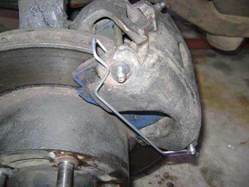

The replacement pins are too short for the clips to be utilized. If you do use the clips with the updated/shorter pins the brakes will work poorly due to the caliper sliding motion being inhibited on the shorter pin by the clip.
