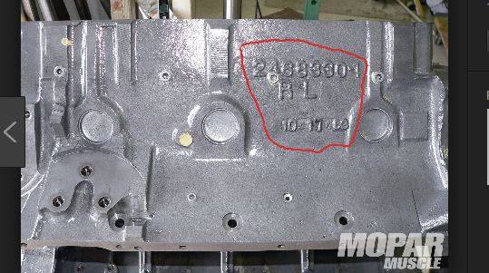

Doesn't seem to be original engine, but what's the casting date? My engine cast 1/19/66 assembled mid Feb. car built 3/8/66. If block cast date is very close to or after car assembly date would answer the question . Have another block cast 1/21/66 and assembled in mid March.

Not sure where to find or interpret the block cast date......
