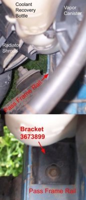

My 74 Charger is a 318 A/C car. I bought it with parts in boxes. My problem is the coolant recovery tank. I have the right tank but missing a bracket. In the parts catalog it calls out part # 3673899 bracket but no pic on Illus. page 7-14. Am I missing page 7-15? Does anyone have a pic of what I need or better yet have one for sale? Thanks
That's a bracket that sits down in the cavity of the frame rail on the right hand side of the radiator where the coolant recovery tank is located. The coolant recovery tank sits on that bracket.
In the attached photo the bracket can be seen below the coolant recovery tank sitting down in the passenger frame rail. It's harder to see in the top photo, but the lower photo is clearer.
Why do I have a 1/2 inch gap between the bottle and radaitor support at the two muonting holes? I dont have that 3673899 bracket on the car and don't recall seeing it. Thanks for the pic.

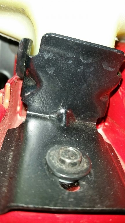

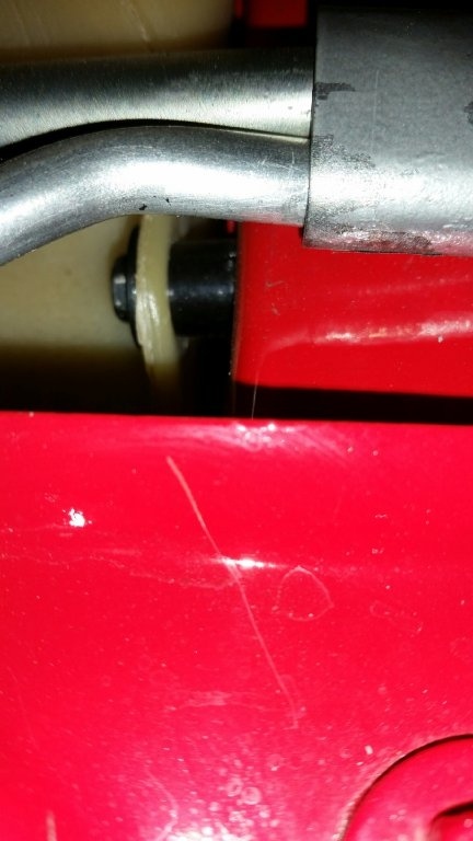

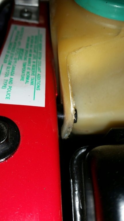

Question, and it may be different on charger vs. roadrunner, but do you have standoffs behind the mounting holes on the bottle that are attached into the radiator support? Here is what they look like on my RR, one on the outside is taller than the one on the inside.
Also, here is a complete view on the bottom bracket.
Thank you very much. I do not have those standoffs nor the bolts. That would fix that problem. And thanks for the pic of that bracket I will need one of those. So is there nuts that go with the mounting bolts and standoffs? On my radiator support the holes are square.
So, the standoffs have a square part that fits those holes and snaps into them plus once you put the screws in, the square part spreads out to hold it in place. I believe the screws are number 8 hex head course thread with captive washer. I used auveco 16583
and filed them down to the correct height because my originals were so brittle they broke when removed. Not sure if anyone specifically sells them for the coolant bottle, but I have seen them for grille mount and headlight bezel mount.
