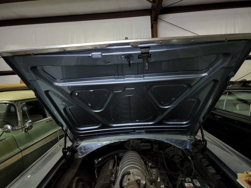

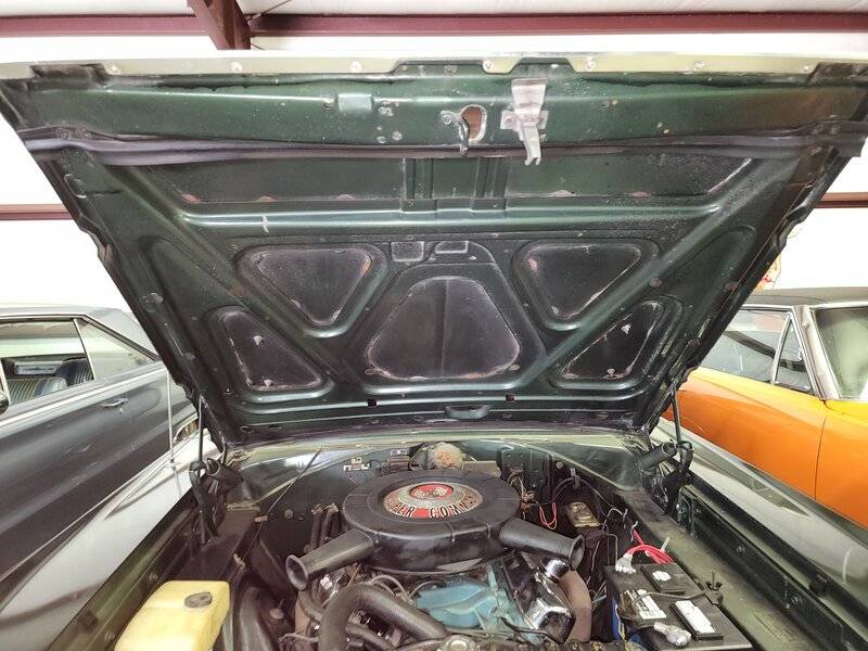

The only physical difference is the understructure. If you are not going to add 67 style hood scoops it won't make any difference.
66 hood
67 hood
Factory hood scoops use the round holes in the understructure on a 67 hood.
