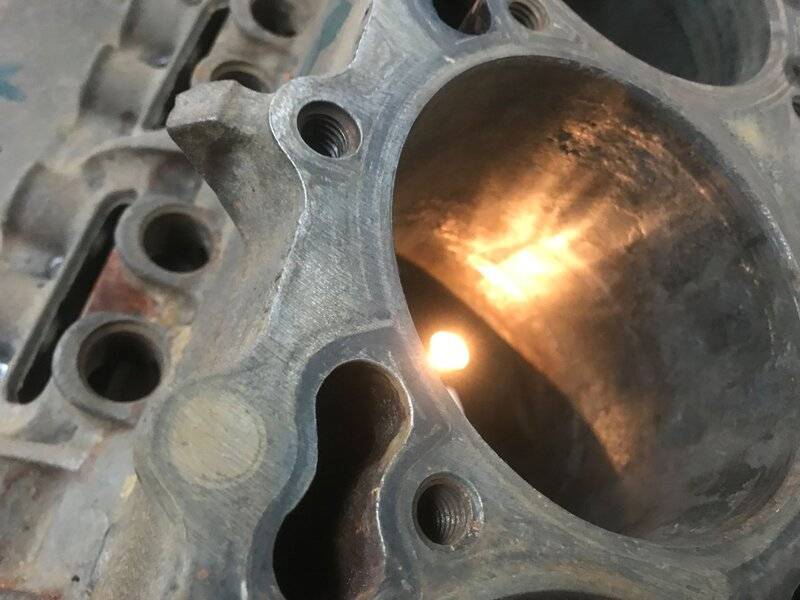

Hey guys I just posted on Lorny's thread about his 440 motorhome find. Well I also just found one. Hard as hens teeth to find my way. And It also came out of a 75 motor home. Anyway to get to the point. Is this thing salvageable. It has some pretty bad pitting in a couple of the cylinders. Six of them are not too bad but the worst one looks like this...
Could this thing be saved with a bore job? Or would it need a sleeve? Is it worth the expense? Like I said these things are not to common anymore up here. Any help or insight would be appreciated.
Thanks Mike for the quick response. Yeah that's the worst one for sure. So a bore job wouldn't fly eh? From what I understand big money to sleeve up eh? then the bore job for everybody else right? Along with the sleeve? I was lucky enough to get the engine for a coffee. So I'm out nothing. I gave it a good cleaning today and it quickly flashed over. I guess I'll wipe it down with some Lucas really good and bag it for now.
A sleeve makes a excellent repair and will last.
The shop we use charges $100 a hole to do a sleeve. They sleeve them all the time.
It's really hard to see the damage in the picture to say if it can be bored enough to clean it up.
Wow that's not too bad! Yes always hard to tell in pictures. That's why I threw some light in there to try to light up the gouges/shadows from the pitting. I also tried to get a straight edge and a feeler gauge in there, but no real way to get a accurate reading with the curvature of the bore. Going to make a few calls on Monday to see what they charge up here in the GWN.

Yes, sleeve it. I have buddies with all 8 holes sleeved in their brand X blocks.

Only your machine shop will know for sure.
No reason to do anymore then the one that is damaged. They will bore the sleeved hole to match the others and likely look for cracks.
When I have seen them sleeve all eight its when they are trying to save a expensive block like a hemi or when they are trying gain a little extra ring sealing in a competive racing such as NHRA superstock.

Your lifter bores need to be checked also. I have a friend that has a ultra rare 68 RR convertible 383 4-speed with air, and it needed one sleeve and the other 7 would clean up with a 30 over. He sleeved all 8 cylinders and built it back stock. It's now a great running numbers car with no engine issues at all.
Let shop decide if pitting only .020 deep bore .060
