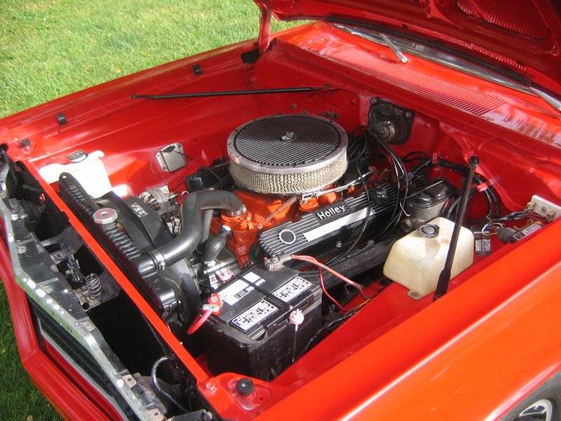

The 318 in this Duster....
May have been the original engine to the car. All 318 2 barrel engines had relatively low compression and a HP peak around 4400-4600 rpms. It's a fuzzy memory but I thought the cam sprocket was retarded at least a tooth on the cam sprocket. Traditionally, retarding a cam moves the power peak later in the RPM scale and lessens power at low RPMs. The problem is/was, an engine with heads as meager as most 318s have will not flow enough air at higher RPMs to take advantage of the delayed power peak.
