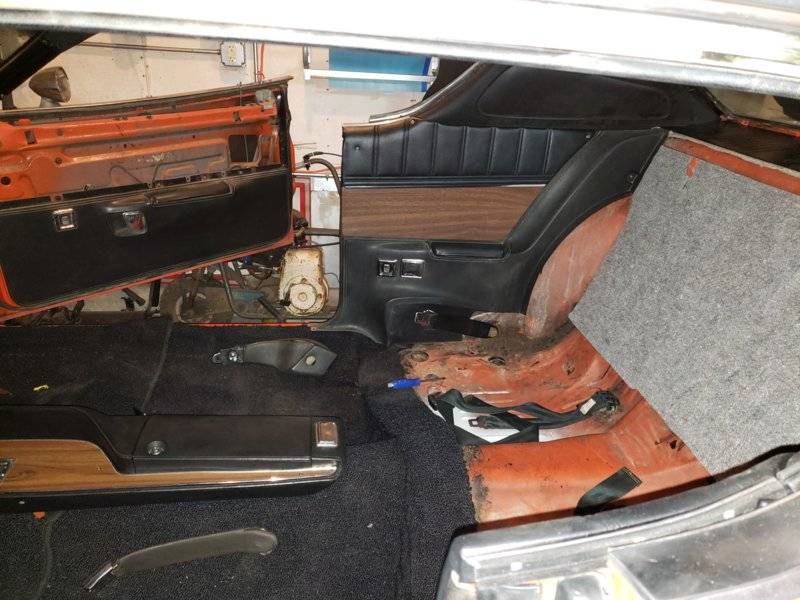

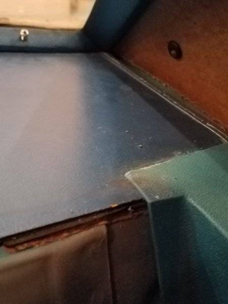

Does this look right? I can't remember how these panels meet. Does the package tray sit on or under these panels?
I thought 71-2 had cloth side panels and 73-4 had the plastic ones?
They had plastic. I think the Coronet's were vinyl or cloth.
Here's a picture of the original and the reproduction. The original was crumbling and chalky.
73 and 74's have plastic. My pakage tray is under both. Not sure on the 72's
my package tray went in before the side panels when I took it apart. that's how I put it back together
tray underneath...at least at the St. Louis plant.
The 73-74 s.e. charger has a cardboard with material on top plastic is on the hard top cars .
