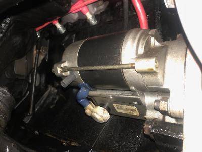

Since I don't know what factory starters look like for Mopar. Is this OEM style or mini? Picture taken on my back underneath
car
Yep, Mini starter. Late model. It is a permanent magnet motor starter. It takes less current to spin and will turn the engine over faster than the OEM starter. Plus, it is smaller, easier to replace and lighter.

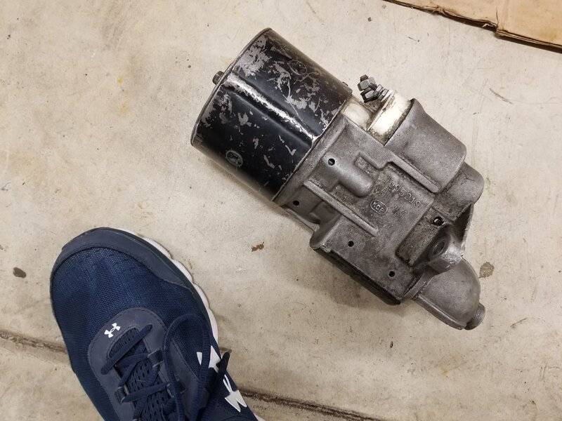

Here's an old-schooler for comparison, '68 model....they're pretty big.
Looks like it could be a MoPar mini starter. The aftermarket also makes starters that look the same. Those came stock on things like a Dakota or Ram.
Excellent starters. Last forever.
Thanks for the quick replies. I was under there fixing a trans leak and thought the starter looked "better" then typical OEM units so I thought I might as well ask.
I did notice when I got the car that it didn't have that distinctive Mopar "whine"when cranking
Yea, it disappears with that starter. They’ll know it’s a MoPar when you run it though!

I looked at pictures online and it looks identical to a 90's Dakota REMY unit
