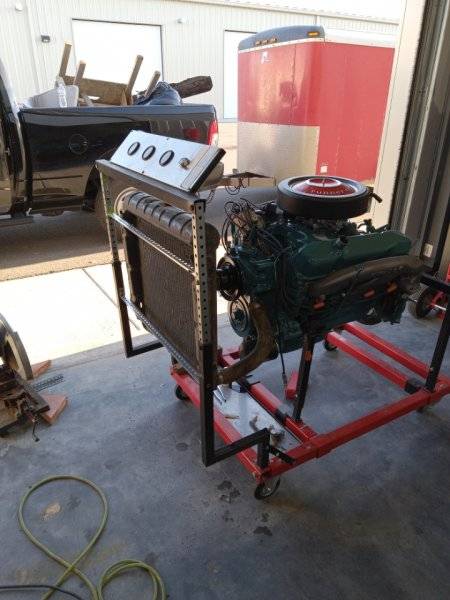

currently the engine is on the run stand(thankfully),was going to run the engine prior to install..

bought a new one last night. thing is, Ive had nothing but chrysler products from day one. dodge pickups,roadrunners darts dusters and never had an issue, I thought they were all the same and I'm 80 % sure it is the staarter I pulled fromunder the bench was the same one i pulled from the car five years ago upon dissasembly.....maybe Im wrong about every starter working with most the mopars but Im just pulling on my own experiences,haha been wrong before! Its my first engine run stand I've ever had and whi;e I'm not an electrical engineer I muddled through and think everything is right on it. new battery, relay etc..starter is getting the power it needs. yesterday after ggogling the issue , I took my dremel and cleaned the pilot hole in the bhousing ,paintand gunk etc.. and then even tryed shimmig the starter..anyway I'll see today,Ill let ya know
