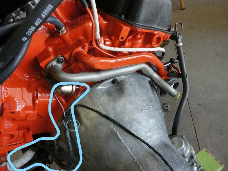

Is this the oil sending unit? Where does the line go to?
That is attached to the battery cable. It runs up by the master cylinder and plugs into the harness by the master cylinder. Hemi specific under hood wire harnesses.
Thanks for the answers. I will have to look up the part number and try to track that part down. That has to be the last part I need to locate for my car assembly. Thank you.
Just an FYI, the sender shown is for an oil GAUGE equipped car.
The oil LIGHT equipped car sender is much smaller
That wiring comes with a reproduction battery cable. So all you need is a few hundred bucks.
He has a Charger, and it’s not his photo since he needs to find this harness.
Exactly, I am using the photo as a reference. I will look at my battery cable more closely, I have the engine outof the car and it is easy enough to look at the battery cable today. Thanks.

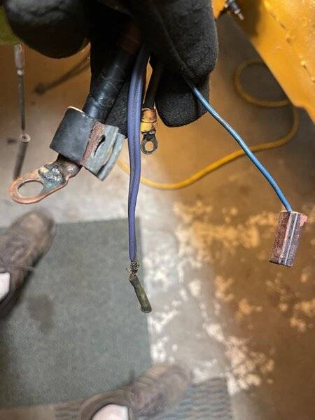

I have posted a photo of my battery cable wires, which come off the positive battery clamp. 4 wires, one for starter is obvious. I looked in my service manual electrical diagram(page 8-125)
low oil pressure switch iwires G6 and G6A are grey. Any thoughts on the other three wires.
I bought the car with the engine out of the car. So I am learning the Hemi wiring from scratch.
