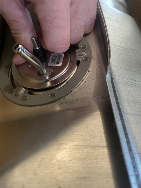

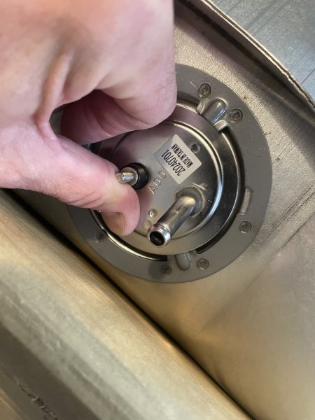

Having trouble installing the sending unit in the tank of my 68 runner.
The unit doesn’t snap all the way in. I think it’s because of the new hard filter sock it comes with. I can push it/force it, not sure that a good idea.
Any suggestion or insight would be appreciated.

Can you make a side by side comparison to the old?? Does it "drop right in" without the sock on?

New tank? Who's sending unit? Bad sending units have long been discussed, not compatible with our gauges. Also, you may have the wrong sending unit. Van's in Wapun, Wisconsin. Have heard that they have a sending unit that is now compatible with our gauges.

I can’t look in there but I can hear it hitting the tank.

Triple checked the tank
It’s the right one
Won’t slide in
If I push it it’ll go
It hits the tank
Just installed new classic industries sending unit in a new AMD tank on Sunday. The tank has 2 notches and the sender has 2 corresponding tabs that go in the notches. Are you sure you’re all lined up?

I can hear and feel the hard sock hitting the tank
