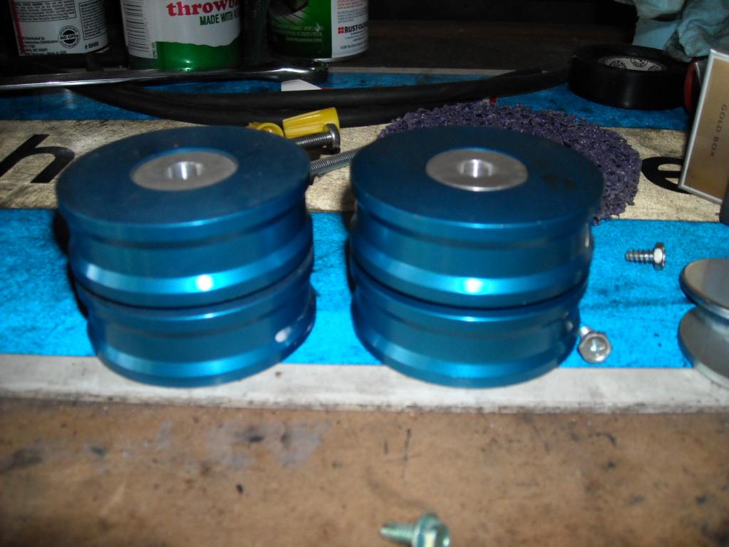

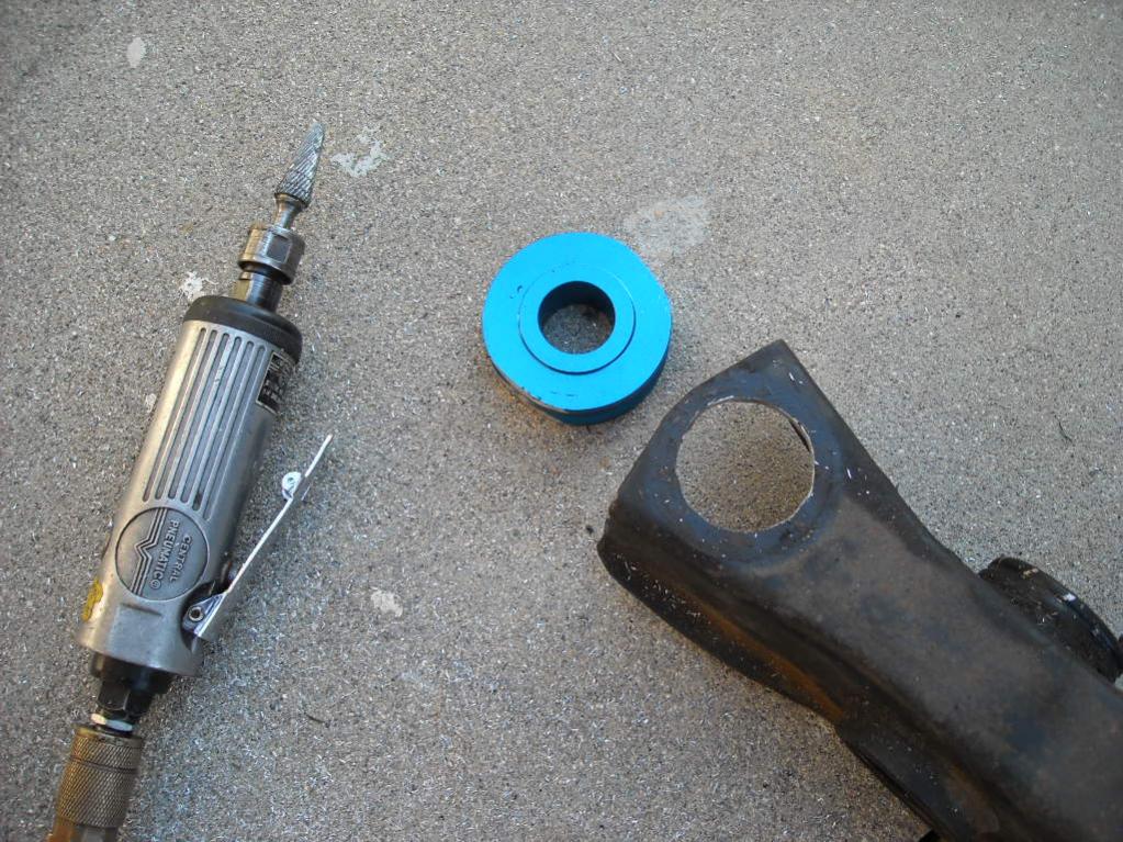

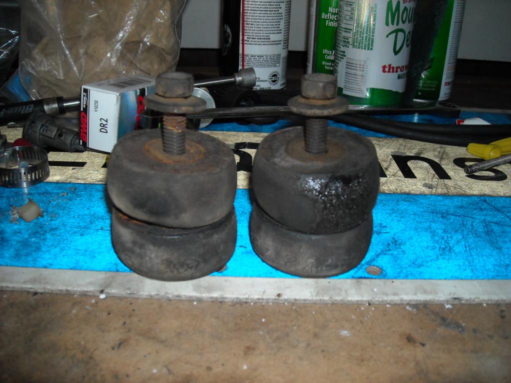

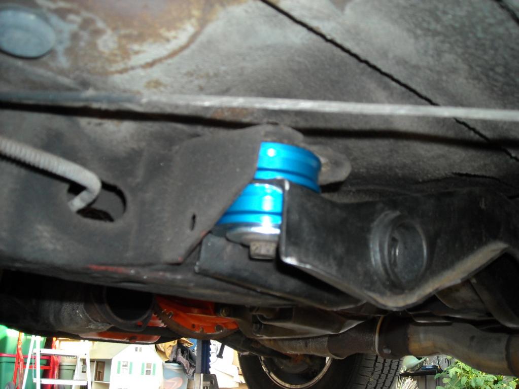

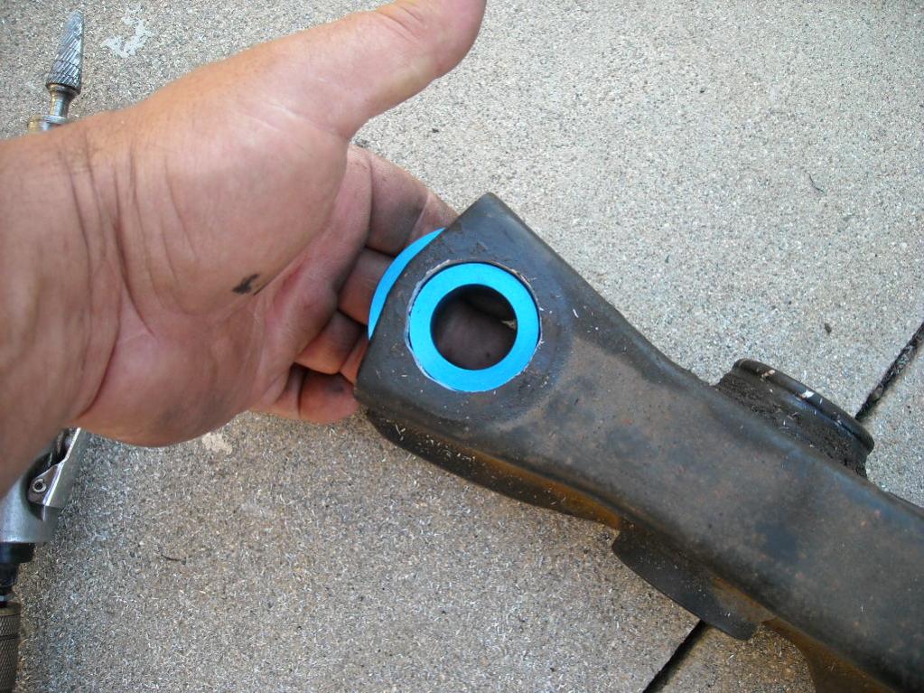

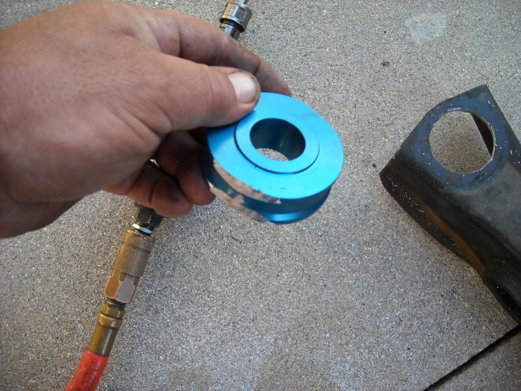

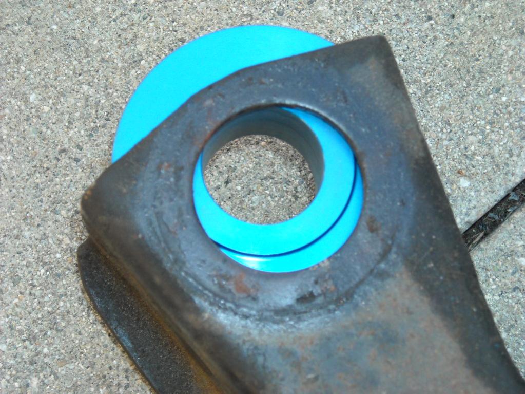

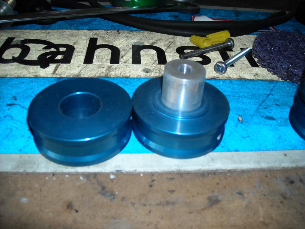

So, messing around in my garage I came up with a cheep solution for the squishy T Bar crossmember bushing on the later B cars. I had a set of solid bushing for a first gen Camaro laying around and thought to myself, "what the hell". I made a sleeve out of some extra aluminum I had to fit inside the bushings and had to grind down the outside of the bushings that actually fit in the crossmember itself. The only other mod was to open up the hole in the crossmember for the register of the solid bushing. Works like a charm and dirt cheap.
