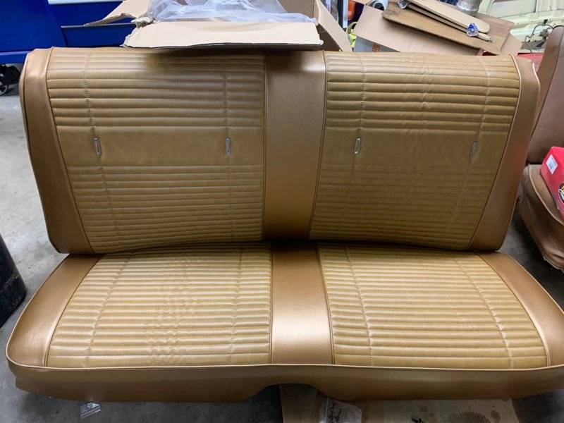

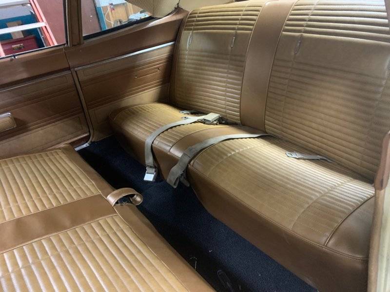

do it yourself, i did mine this winter, its not easy work but very doable
As mentioned above, do it yourself. It isn't all that difficult I did mine in my 66 Chrysler 300 that I had...Fronts only, and then in my 66 Plymouth Satellite both Front and Rear. Granted I had some help from 69a100, but after a bit I finished the job myself. The Legendary Kits are really easy to work. Get yourself some Hog Ring pliers and Hog Rings and go to town. Just save all the Lasting from your old seats as they will need to be used. Good Luck, take your time, and enjoy the experience...cr8crshr/Bill :thumbsup::thumbsup::thumbsup::usflag::usflag::usflag:
