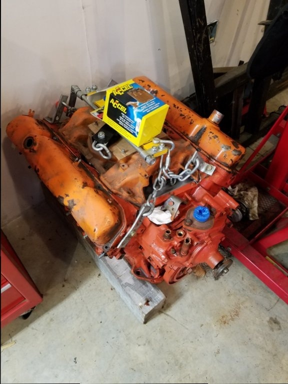

Well last summer I installed a very healthy 383 in the RR I had built many moons ago.
That lasted 3 months, not the engine but a buyer that just had to have it. After an insane offer, out it went......... engine less again.......
Plans were to do a mild 451 with a 400 I had laying around, well once back from machining......another crazy $$$ offer for that. Engine less again.
Got a call from a guy I built another 383 approximately 4 yrs ago for a competitive pulling truck, he was in dire straits.....
Long story already, but here is this weekends plan.
it left here with a Hughes cam, but now has an unknown Purple shaft. Heard it run last fall and know it's healthy. My book says it's .30, 11.3 with my ported 906 still on (always mark my work) but cam?? Should be running this weekend ........

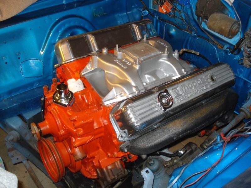

Well, misleading a little. Picked up the engine Tues. On stand, 7 qt pan & pickup installed, bearings checked on Wednesday. Re- gasketed, painted-made pretty, manifolds installed Thursday.
Last night was the install with the 3 of us, ME, myself, and I. We work well together kinda- except I really don't like one of them (he's sarcastic), and can't trust the other. And the last one drank too much coffee and can't fall asleep now. Back to the garage.
Personally I kind of like the polished/cast valve covers...looks good sitting in the bay!
Well they were kinda growing on me, but when priming oil poured out. Forgot some of these older cast covers interfere w/ stock manifolds. Chrome ones goin back on for now, header upgrade coming soon. All for naught, as I'm pretty close to firing but then big storm rolled through. Off to work I go, guess people like to have their power back on. Don't they understand this is important? Rest of weekend is shot now.:(
Can't the people buy generators? Selfish bastards
Yeah, I have the black Mopar Performance covers and after I replaced the cam, the right bank simply would not seal. I had to use RTV to seal it.
