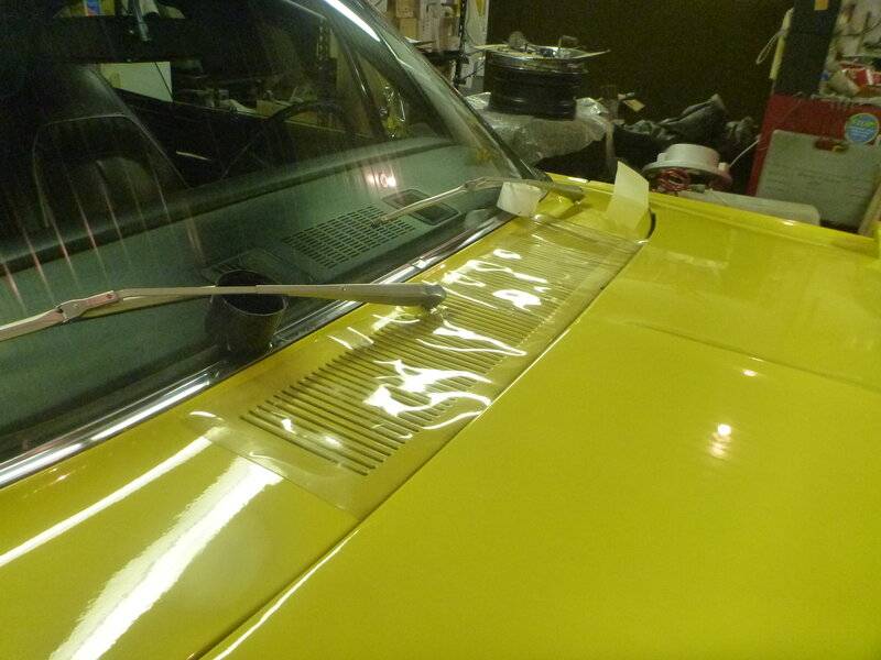

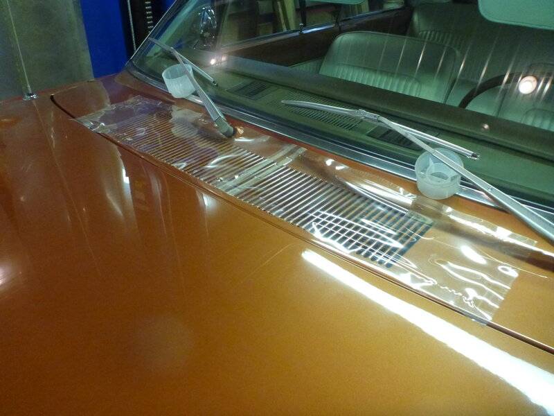

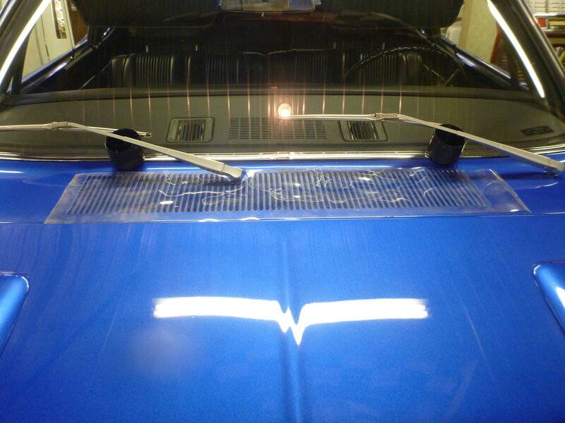

......... get'm corked, covered and the windows up tight before the mice try to move in for Winter. Then crank up the tunes to help keep them at bay!

Wayne can you tell me why the paint tops under the wipers please.
I don't like buying NOS refills, saves the rubber if they're not jammed into the windshield. I put them up every time they get parked in the garage.
Oh, I get it. Never saw that before but it sure makes sense.

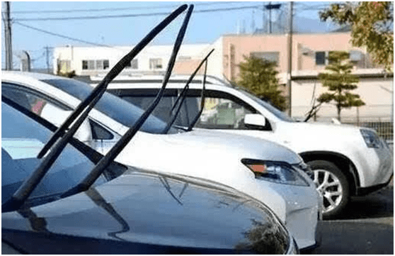

In some countries I've visited (Thailand for instance) everyone parks their cars in the day with the wipers raised. I think the hot sun and dust wreck the rubber when sitting on a hot windshield all day. It looked stupid to me but makes sense. The issue with long term storage is the pressure from the wiper arm spring bends the rubber flat against the glass and cracks the the rubber.

I've seen people put their wipers up when parked, so they don't stick to the windshield in snow or freezing rain.

Not bashing the plastic over the cowl but there's a huge open door into that cowl under the front fenders which I believe is where they enter. While mine was apart I noticed this as an entrance and riveted some stainless expanded metal over it. Doing absolutely nothing else I've never had a mouse get into my car.
Cars aren't parked anywhere they aren't normally, can still be driven at a moments notice. Yes there's a drain hole on each end of the cowl pans, pretty much plugged during resto on the Bee, but following the piss trails when the Bird was in the hangar for a few years the mice went down the vent slots on top and into the heater box.
Another entry point is the gap in the cat whiskers between the front and rear side glass, I tape this shut on the Bird.
