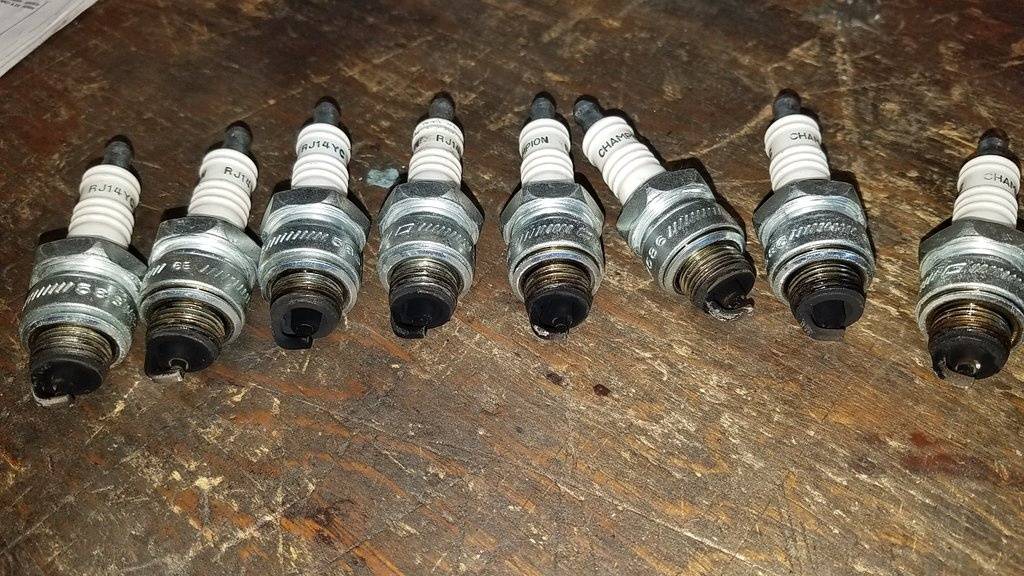

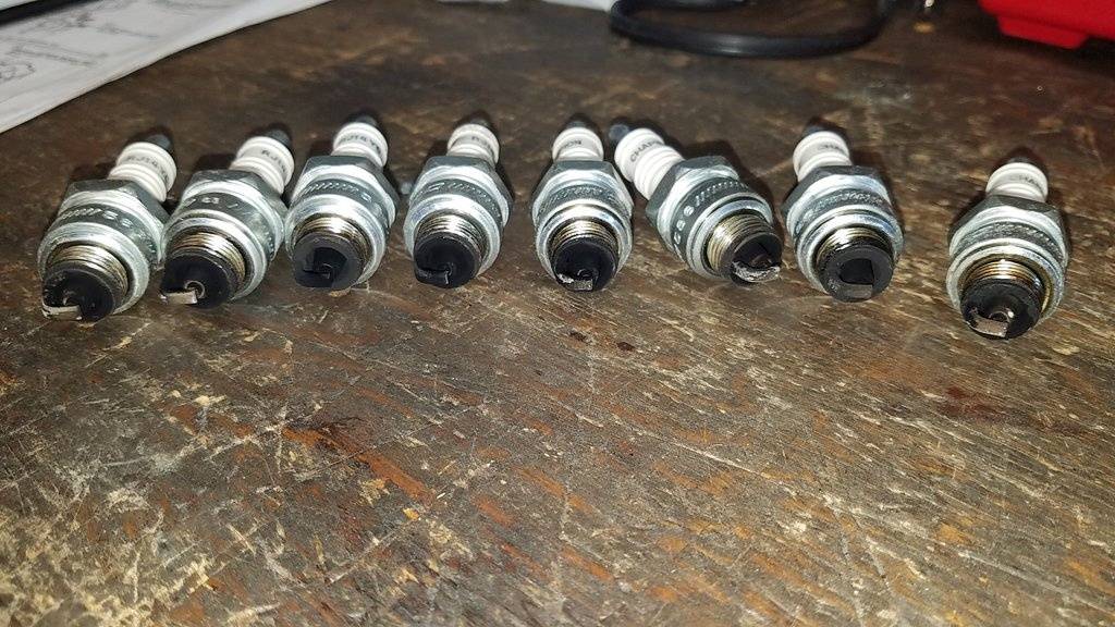

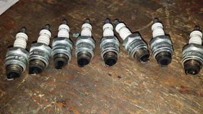

I have a 1973 charger 400 bb 2bbl auto.
So one day I noticed my car idle great and ran great when it was cold on the way to work ( I work graveyard) but gradually (3days) when coming home it was colder out it would fall on its nose and it was harder to get up to speed to get on the freeway it would clean out and then run fine. I decided to change the spark plugs and noticed a lot of black on them and they didn't even have 500 miles on them I didn't notice any wet oil residue on the spark plugs though just really black. I changed the spark plugs and started up and idle great everything but soon as I put it in drive and I started going it started backfiring and popping I couldn't even get it up to speed. So I've decided that maybe it needed new plug wires coil cap and rotor. The carburetor is brand new and it ran fine before all this happened I checked the timing and the timing was fine. I think the valve guides might be going because I'm getting allot of black soot out the tail pipe when it's cold which got me thinking maybe that's why the spark plugs are so black i tried leaning it out a little but it still kept doing it. I'm about ready to take it to a guy I know that has a hot rod shop and have them look at it because I'm pretty much at my wits end trying to figure out what's going on with this thing. Any help or suggestions are greatly appreciated thank you.
From your description and pictures of the plugs it's running rich. More engine specs would help Carb+jetting, cam, intake...
You probably cracked a plug, improper gap or crossed a plug wire if it was running fine before you touched it other than just
2bbl Holley ND 2577 don't know the jetting off hand stock cam stock intake.
Are you running the factory Champion spark plug ? Valve guides/ leak oil...blue/grey smoke. Rich fuel mixture..black smoke ....Don't throw any more parts at it until you learn to diagnose the problem correctly. If you don't know the difference between burning oil and a rich fuel mixture, you are just throwing your money away. Take it to a shop with a good reputation and let them do the diagnosis. At least you will get some kind of warranty if it fails to fix your problem.

For sure you're very rich on your mixture. Plugs will be black after periods of long idling but should clean up during long hard runs at higher speeds. This is obviously an "air/fuel" ratio problem and requires a meter to diagnose just how severe it is. I note one statement you made: "The carburetor is brand new and it ran fine before all this happened" so I'm thinking that therein lies your problem. Perhaps the carb is having a hard time maintaining the A/F ratio and if you could substitute it for another you may or may not see a difference. Got a buddy who would allow you to mount his "known to be good" carb on your engine? You not only need decent A/F ratios but also proper engine temperature and a clean burn. Too much fuel, too small a carb (yes that can cause it when it comes to metering fuel), poor spark due to low secondary voltage, timing and wrong plug heat range, and premature plug fowling that can't clean itself up are all possible issues. You need an experienced diagnostic done. Kitchen sinks can get expensive after a while.
