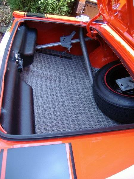

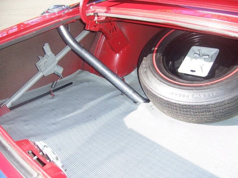

Does anyone have close-up pics of the correct way to stow your jack, jack handle, and that little "spring" that holds down the jack handle? The tiny drawing on the trunk decal

Just google images. 1969 Dodge Charger jack hold down. Like this.

Can't help you there, those1968 parts pictured are all factory with factory paint.
