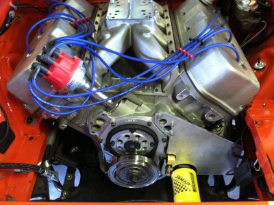

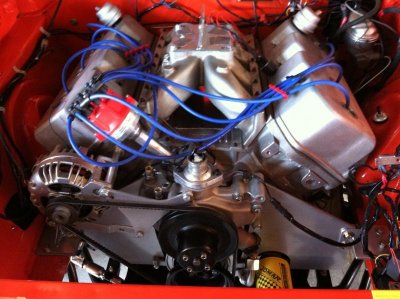

Roadrunner for street use only and has a fire breathing monster 533" Hemi which is an all aluminum Indy Hemi

I think I need a picture of the eng please

Well it's a great looking car Charlie, Anything more you can tell us about your Hemi??
