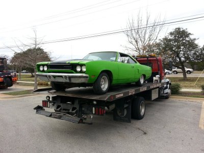

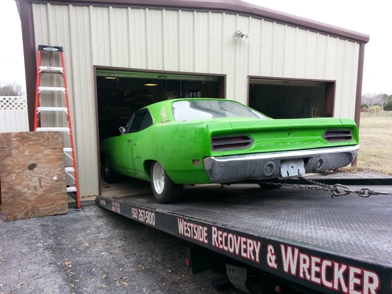

A few introduction pictures follow. Arrival:
Ready for home:

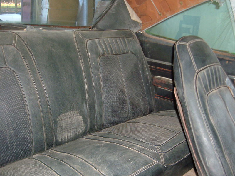

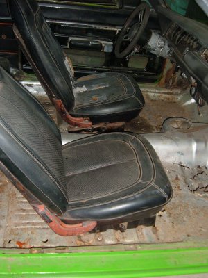

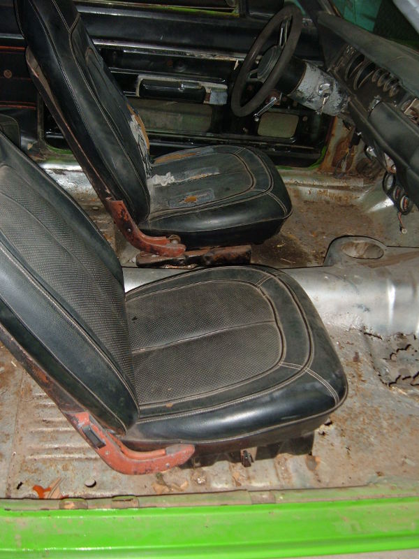

More pictures. The interior:

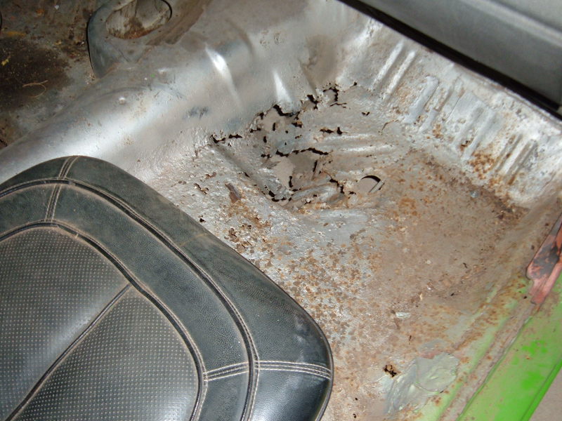

As I mentioned, most panels will need replacement:

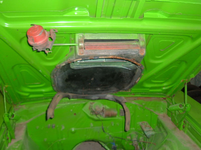

And the air grabber has seen better days:

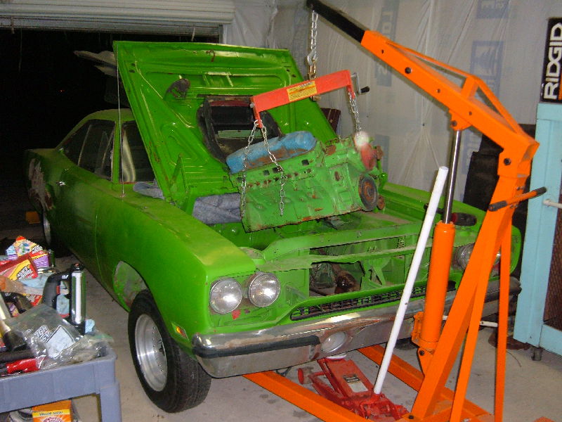

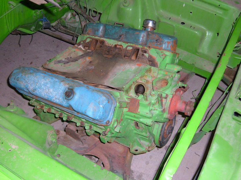

So this past weekend I finally got around to doing some work on her. Engine stuff is my favorite part of any build/restoration, with bodywork being the least. Boy but is this project gonna be trying at times! :) Being that as it may, the engine needed to be removed anyway, so I decided to begin there. Whoever put the engine in like this was ... well. They just were [fill in the blank with your choice explicitive]:

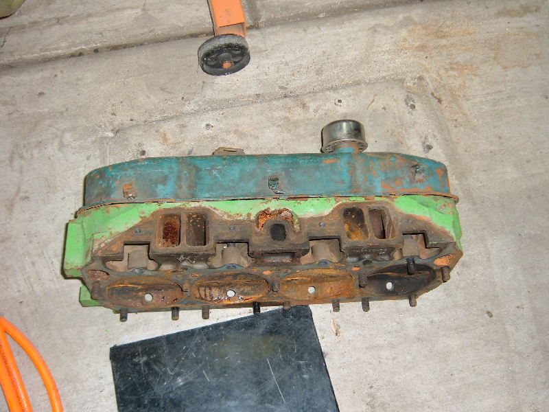

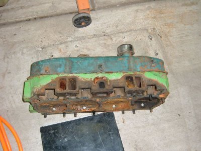

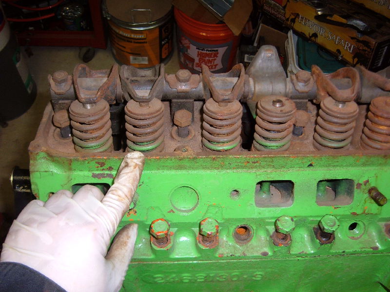

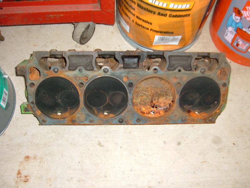

I had to remove the driver's side head just to get the thing out. Like the remainder of the engine, it's seen better days:

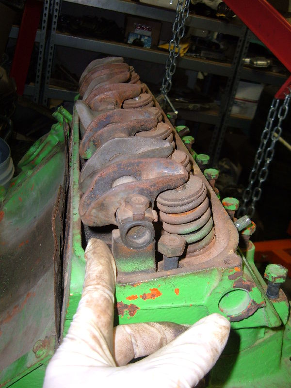

Yeah I'd say this thing has been sitting for a while:
Been stuck for a while.jpgPax side head.jpgPax side cylinders.jpgStuff in valley.jpg

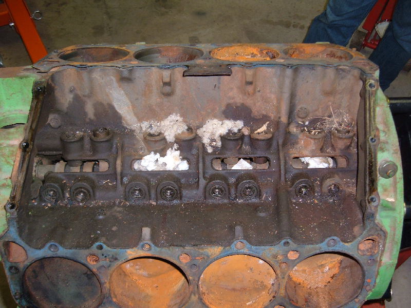

I guess someone decided to keep the push rods as a souveneir:
Nice taping work on this engine spray, huh?
Bottom side didn't look too bad:

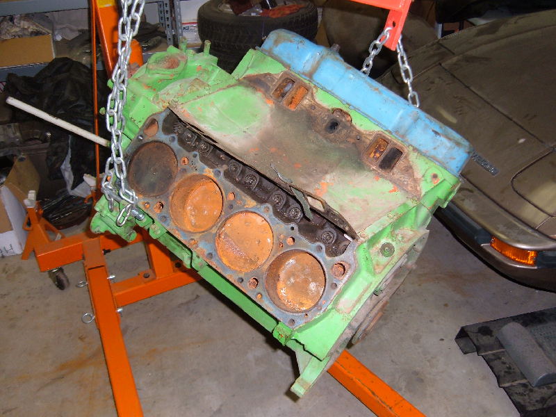

Naturally she's stuck solid. I've been spending a couple of nights cleaning and lubricating, as well as attempting to clean the bores. But I digress. I won't really know anything until I take it to the machine shop, so I'm currently reserving judgement at the present time. We'll see.

Welcome to the site - there are a lot of helpful and knowledgeable people willing to help answer your questions on this board. And welcome to the world of "project cars". By the way, IMO the green engine paint has to go.

Hey Jerry, nice to see some photos of your car. It's amazing what we find under something that looks good on the outside. Don't worry about how long it takes to get your ride looking the way you want it. Mine's been a project 20 years in the making (but don't take that long,ok). The good news is that those year B-bodies have all the replacement parts/panels you need for it. I have to agree, that John Deere green on the engine has got to go. I would find another way to set your hood somewhere (see photo), one bump and it could go down and cause more damage that you don't need/want to repair. Good luck on your car.

hunt2elk and roadrunnerman and others - Yeah I wasn't/am not a fan of the green engine color either. From what I was told that was done two or three owners ago, all of whom pretty much let the car just sit around. Judging from the horrible body work (1/2" of filler - REALLY?!) and other obvious evidence it seems clear to me that was indeed the case. But it is what it is and it's mine now so I'll change all of that.

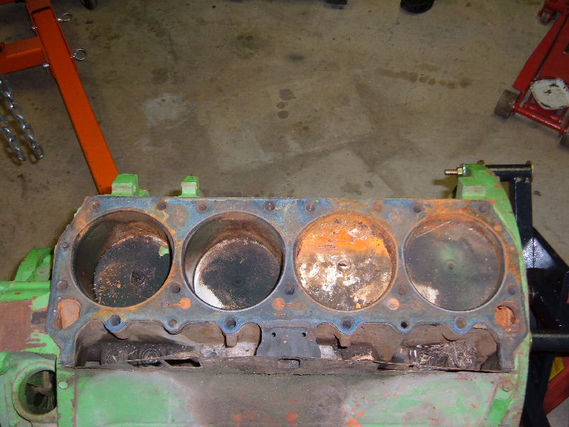

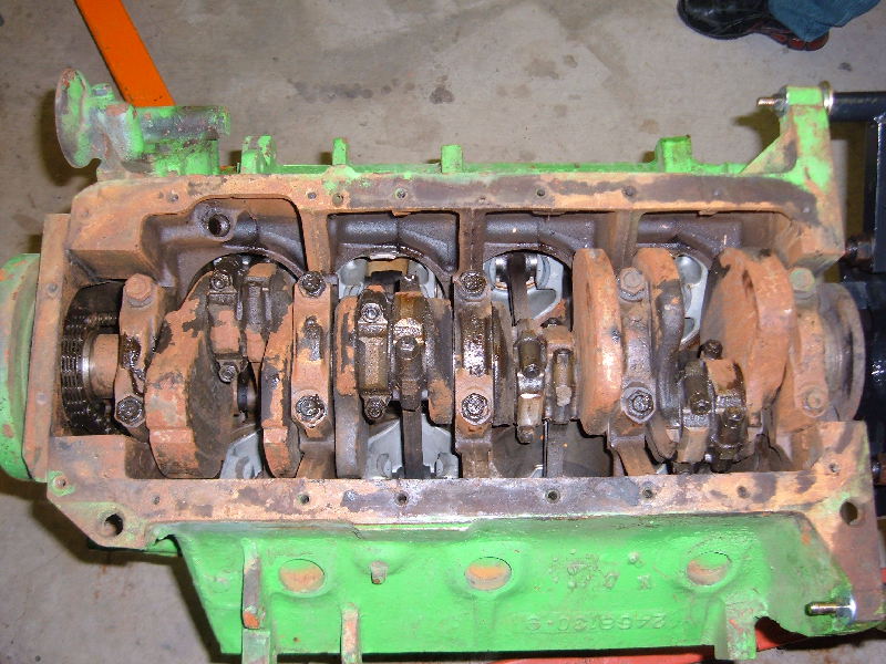

After a week of overnight soaking in lightweight oil, regular oil, WD-40, combinations thereof and finally acetone last night, I decided that it was time for the gloves to come off and the engine to come apart. And tonight was gonna be the night. She had put up a hell of a fight, gotta give her that. I have a couple of observations and a couple of questions.
As I mentioned, she was stuck solid. To get it apart, I removed the mains and all of the rod caps that I could get to. I couldn't turn the crank, but with only a couple of rod caps remaining, I could free the crank vertically enough to allow it to turn just a bit. Worked that back and forth, got to the final two nuts, removed those caps and did something I really don't like doing: I pulled the crank up and out of the block. The rods do articulate and get out of your way for the most part, but I still don't like doing that. But you don't have much choice in these cases. Then I had 7 remaining pistons to remove (was able to get one out with the crank still installed). With the significant amount of rust and other crud in the bores, they just weren't gonna go easy into the night. So I did something else I don't like doing: I decided to sacrifice the pistons and in most cases the walls too. Turned her upside down, used a bar and hammer-shocked them out of their respective cylinders. It works but it's just "nasty". But whichever. Gotta do what ya gotta do.
The bores measured out at 4.25 which tells me that they haven't been mucked with yet. Is that correct? My 383 has hydraulic lifters. Was that standard in these engines in 70? What do the oil pump gear clearances look like? I don't know much about Mopars, but these sure felt loose to me.
