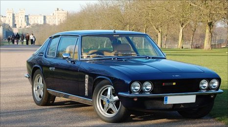

wait, what about this interceptor? it had a 440 in it :toothy12:
