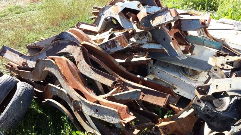

Out of the over 50 bodies that I have drilled out and dismantled none of the 66-74 frames were coated on the inside. All of the 62-65 frames were coated. One reason why I have sold 10 times of the 66-74 frames than the 62-65 ones. The 62-65 frames just don't rust out like the later ones.
You have a good point HOWEVER the dip line is clearly visible on my '69. Also, all that bubbly crap that's in all the beads in the floor and trunk is dried up "dip" that was unable to drain before paint.
I thought the same until I started pulling floor pans. Why are the 66-74 frames a bit rusty inside and the 62-65 frames are not. The earlier frames have a gray coating and the later ones are bare metal. Just what I have found. All my stuff is from the SW desert.
If I think of it today I'll post some pics of the inside of my '69 frame - grey coating. They still rusted but there is no perfect coating and mine was subjected to northern winters with salted roads. The salt will do in anything !!
