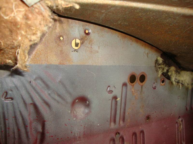

The whole body was lowered level into the dip primer tank just above the headlight bracket and rear taillight......Picture below shows the inside of a door.....The darker grey is the original dip primer and above that is the phosphate.....Notice how the line goes to the far left of the picture.
It was a wash primer so once the car came out of the dip. They removed the primer off the exterior panels and baked the car. Then the exterior metal got spayed with a red oxide primer, baked and then final color....

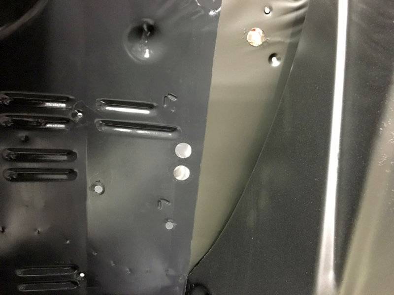

This is the recreation of the dipping process on the GTX.....Above the dip line we spent a lot of time to find a paint that came close to a bare steel look. The picture makes it look different than what it actually appears.....Basically, we taped a line around the interior perimeter and the exterior perimeter.......

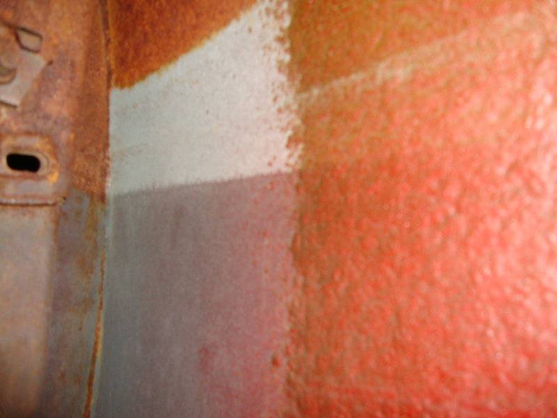

Mopars were never dipped period. Those bad *** rides dove into those corrosion proofing tanks. Lol:fool:
So the insides of your frame rails were coated?
Out of the over 50 bodies that I have drilled out and dismantled none of the 66-74 frames were coated on the inside. All of the 62-65 frames were coated. One reason why I have sold 10 times of the 66-74 frames than the 62-65 ones. The 62-65 frames just don't rust out like the later ones.
