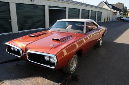

I know you already have that 383. If I were you and you wanted the low block look, I would go with a 400 stroked out to 451. Stock 440 crank turned down to accept Chevy 454 rods. 440 source pistons. They make killer HP and torque. I was going to go that route on my FK5 bee. I decided to go 440 because it's a better deal. Frankly, on an N code car it's a do as you please affair. Especially since you are keeping it. You aren't killing off a hemi car by welding in tubs and a cage, so no worries about ruining a piece of valuable mopar history. Have fun with it! BTW, I didn't do a rotisserie rest on mine. The floor pans and underside still show the original undercoating. My car is VERY nice, but will be DRIVEN. I couldn't see spending the money and energy to do the work that will just get dirty, and who cares? Say what you will, I will be enjoying my car. It's a hotrod and I am building it my way. I hope you do the same. You'll be happier for it. Screen Shot 2014-06-10 at 1.55.47 PM.jpg
I know you already have that 383. If I were you and you wanted the low block look, I would go with a 400 stroked out to 451. Stock 440 crank turned down to accept Chevy 454 rods. 440 source pistons. They make killer HP and torque. I was going to go that route on my FK5 bee. I decided to go 440 because it's a better deal. Frankly, on an N code car it's a do as you please affair. Especially since you are keeping it. You aren't killing off a hemi car by welding in tubs and a cage, so no worries about ruining a piece of valuable mopar history. Have fun with it! BTW, I didn't do a rotisserie rest on mine. The floor pans and underside still show the original undercoating. My car is VERY nice, but will be DRIVEN. I couldn't see spending the money and energy to do the work that will just get dirty, and who cares? Say what you will, I will be enjoying my car. It's a hotrod and I am building it my way. I hope you do the same. You'll be happier for it.View attachment 192630
I know that a rotisserie may not be needed but I would feel better about diving into the body and paintwork just once and not having to worry about it. I am not looking for a 100k car but something that when I build it this time then it will be done for a good while. I am trying to see what the cost would be on a stroker Hemi vs a stroker 440. Then there is always a turbo to make the HP I would like aswell.

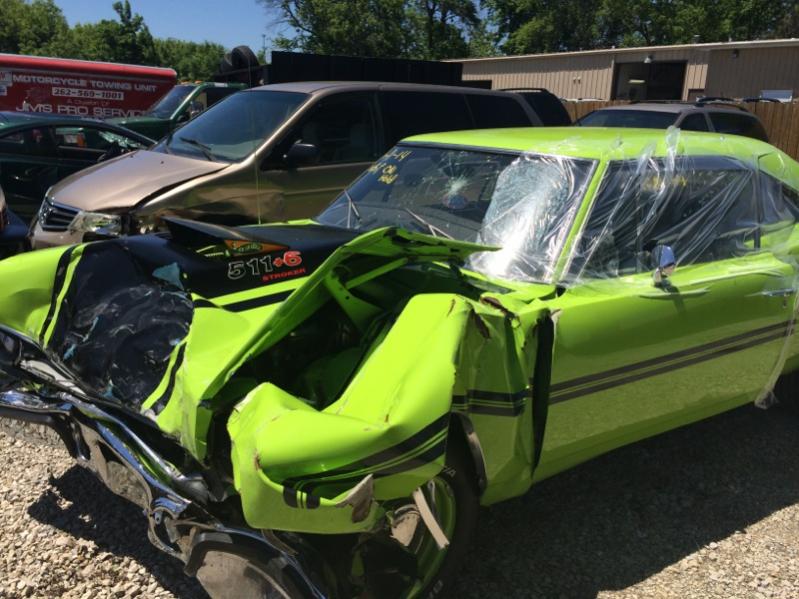

Just don't lose control like this guy.
