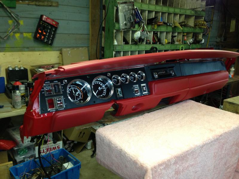

I sent one of my dash pads to Just dashes to get redone, got it back a few days ago and when i went to install it yesterday i noticed the key hole was 1/2" off. Anyone else run into this problem.. Thanks
There will be just a little bit of give on the adjustment of where that lower dashpad will secure down. The holes through the metal dash frame are about twice the diameter of the studs coming out of the pad. Have you tried loosening up the pal nuts and playing with the alignment of the pad? Usually just dashes work is pretty dead on. But, that's not to say they couldn't have had an employee do a shotty job. I'd call'em up if you can't make it align. My guess would be that they would be quick to fix it for you.
Thanks. Im gonna elongate them more today and see what happens. Its not a little off, its way off. I ll keep u posted. Thanks
Enlarged the holes as big as i could get them n a little brute force and it Fits good now image.jpg
damn that looks sweet! for future reference, a heat gun is a very valuable tool when working with dash fitment:)
I concur "beautiful dash".
Glad you were able to make things fit. Based on my own experience with these guys, I think that if you are not Roger Gibson or some other high end resto shop, the quality of work lacks.
