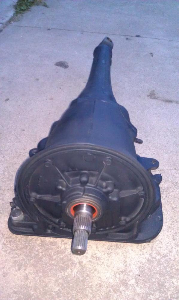

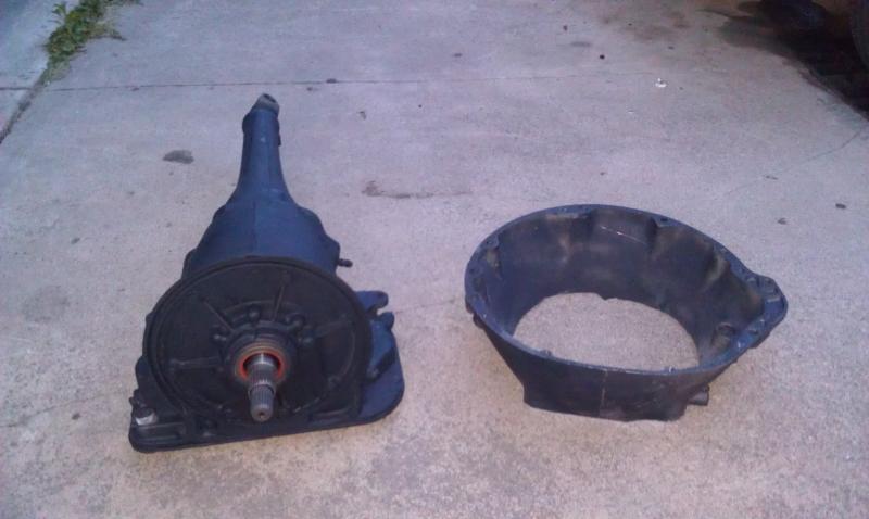

Well, I have the JW bellhousing conversion down to about 45 minutes ready for bellhousing to be bolted on.
A Matabo cut off wheel to get the factory bellhousing cut off close, then follow up with a grinder disk to smooth things out nicely!
All that's left is to bolt it onto the front pump surface.
Here are a couple pictures showing the bellhousing removed, and then a better shot of the trans finished up ready for the bellhousing.
