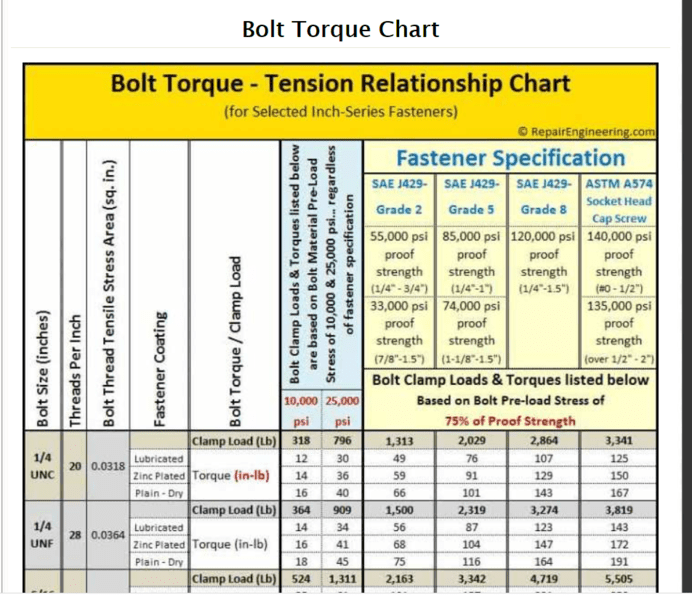

Alright, so here's what's going on, replaced the K frame rubber isolators with the Firm Feel aluminum pucks. Looking at my faithful FSM the torque for the bolts is 50 ft/lbs, but that is for the rubber bushings, not solid ones. I know the 69 and 70 called for 150 ft/lbs of torque, but what did the 72 have and/or what should mine be at now? Any information/experience would be appreciated.
Mark
Since you've changed the variables perhaps just a conventional chart would be a good choice.
Something like this:
http://www.repairengineering.com/bolt-torque-chart.html
