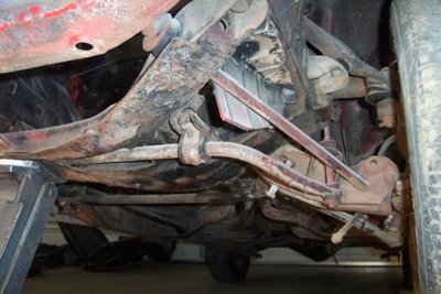

I actually just found a picture on Detroit muscle. I bought mine from Classic and they didn't have a picture. In case someone else has a brain fart like me, I attached it below.

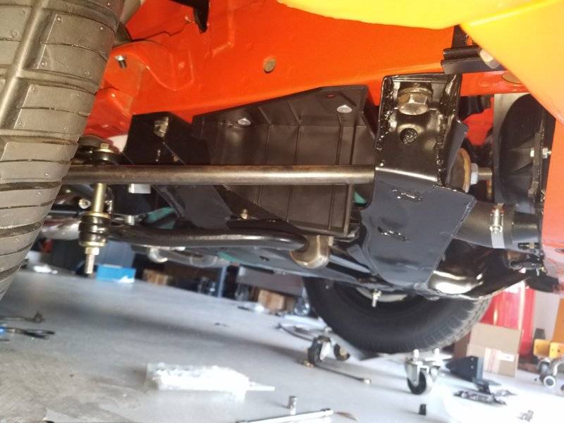

Thank you all for the help and support. I was trying to put it to far back behind the k frame. It helps when you know where it goes. I got it figured out now. Strangely enough I did not have holes on the drivers side and it would not fit anyways. I didnt take one off during disassembly so I thought it might have been lost. Here is the finished product.
