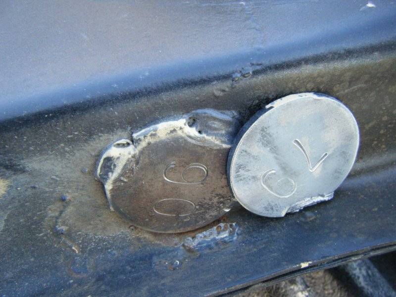

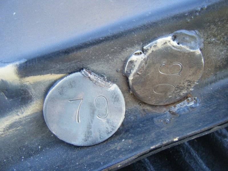

hello

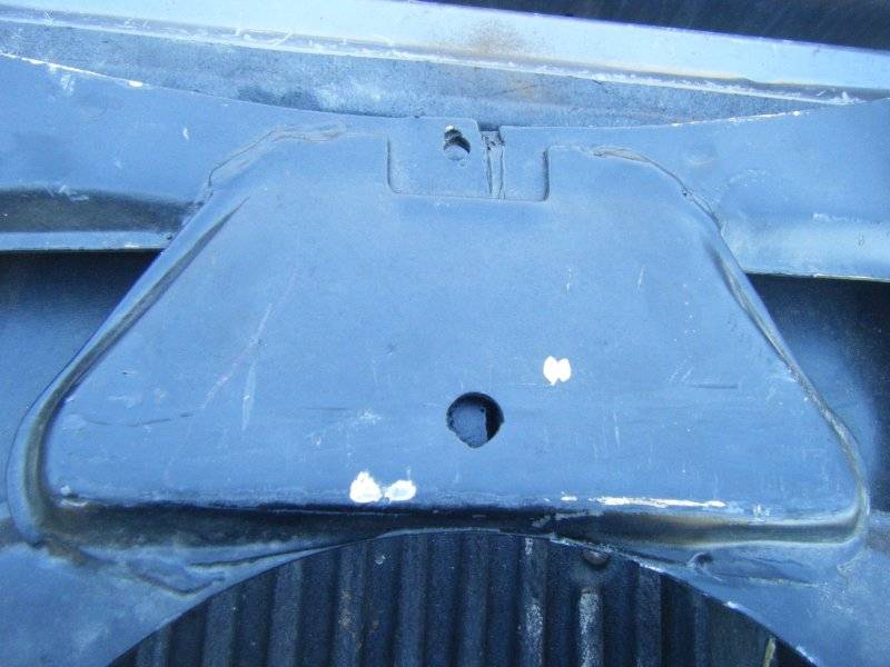

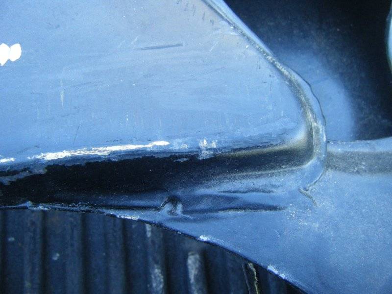

i picked up a k frame with round coins a round coin with 79 was tack welded on top of another coin that is stamped 90 k frame does have a smaller version skid plate. Skid plate seems to look factory weld. any thoughts thanks sjm

The front suspension cross member, or K-member, for 1970 B-bodies with 318 or 383 is part number 2962090, identification tag "90".
The K-member for 1970 B-bodies with 440 and skid plate is part number 3466479, identification tag "79".
The factory modified 2962090 to produce a 3466479 appears like the pictured K-member.

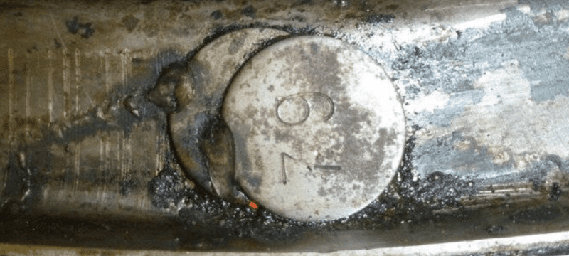

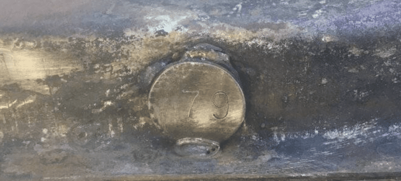

The following images show a couple of other examples of the tag welded over the other tag:
