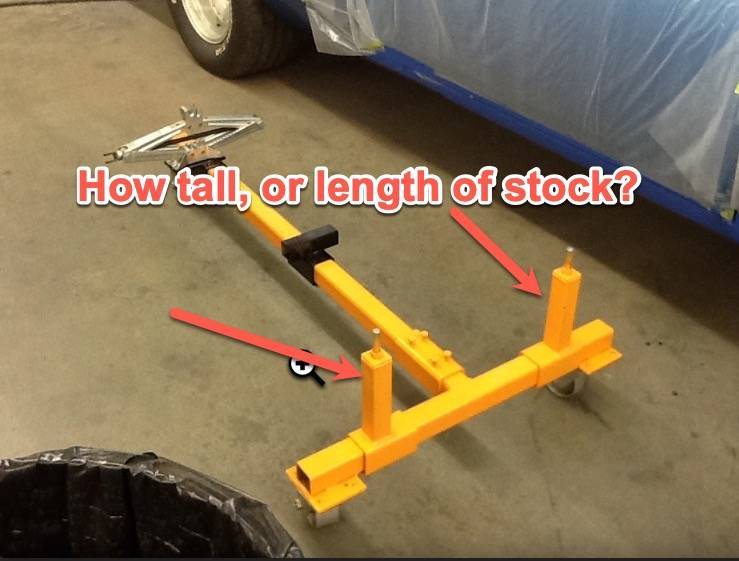

Likely will put this together over the weekend. How tall should the uprights be? Thanks!
I'll go out on a limb.....just tall enough so the brakes don't drag the pavement while attached to the K member?

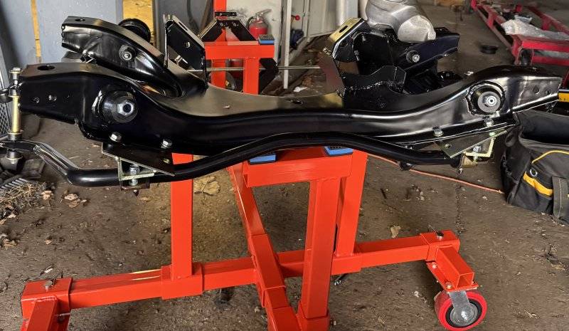

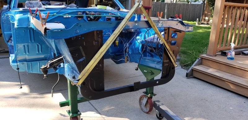

If you're looking for a measurement, I can have one for you in a few minutes....
The bare frame looks like this, I used 2" x 3 1/2" metal stock at the same angle as the K member. From steel to floor is 15 1/2"
I used rubber cushions though to keep from scratching the paint...
The cushions are 3/4" so in reality, I'm at 16 1/4" from the concrete.
Cheers...

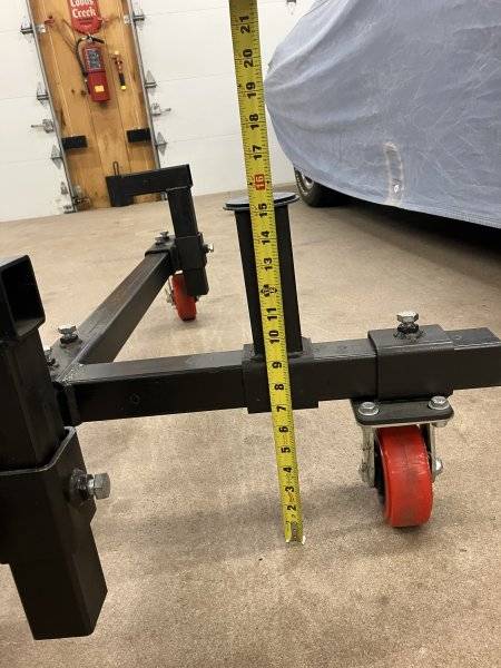

The higher you make it the easier it is to crawl under, line it up and bolt it in. But how high can you raise the car to get it under?

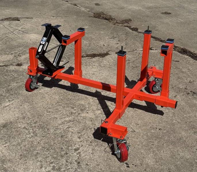

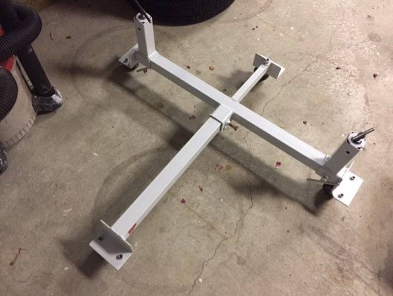

Just built a similar one, and the schematic I went off of shows 4” from the flat at the base of the stud to the top of the frame tubing…
It also shows the stud to be 4”, 1/2” diameter. I think I might have used a 4 1/2 long bolt because it was what I had. I intend to shorten it so the k-frame can sit on the square tubing but want to get some rubber pads on the contact areas first. Mine…
Top of the square tube (where the round post starts) to the ground is roughly 11 1/2".

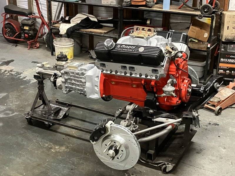

Sorry, no. I bought that from US Car Tools I think (years back). I was lucky and bought a demo/floor model and got a decent price break.

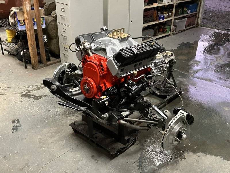

I purposefully made mine taller as I have a 2 post lift and this gives me more room under the car for accessing the bolts etc..

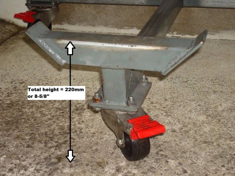

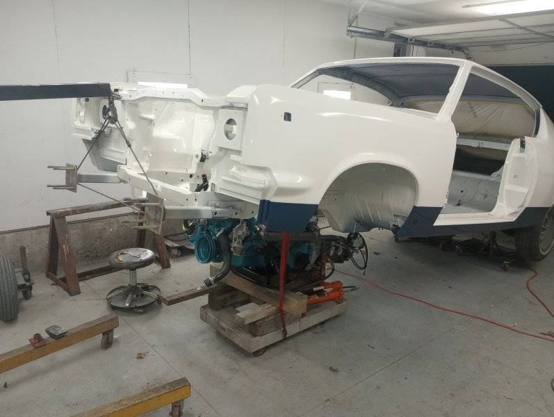

I took the easy way out and used a temporarily modified furniture dolly. The goal was to keep it as low as possible to avoid lifting the car so high. Access to the K -frame bolts was not a problem…
