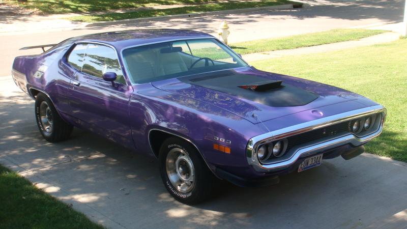

What do you want to do with the car?My 71 with stock suspension rides and handles very nice.
