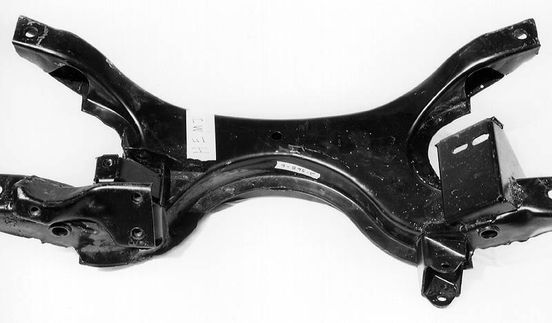

Can some one verify the a different K for the hemi. Looked in my buddy's parts book and found 1/2 of the page missing. As per his memory, "BB and hemi the same".
BB & Hemi are definitely not the same....
B body Hemi
E body Hemi
